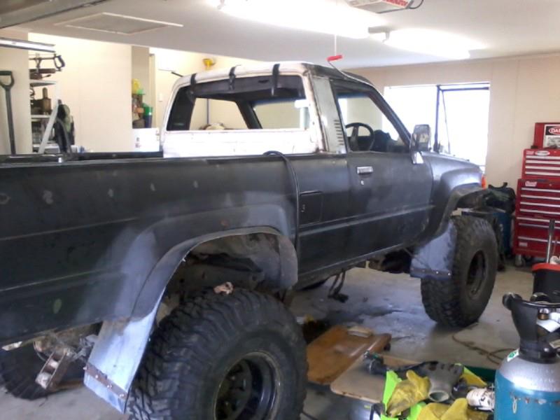

I thought i would post up some picks of my surf. This is it 3rd rebuild, 1st one wasent done by me. Ill try post some pics up,
current build specs.
1998 3rz and auto
RUF -Falcons in the back 14" procomp shocks
front diff moved forward 75ish mm cross over steering
rearlocker, trailgear extended driveshaft slipjoint for front.
37" goodyear MTRs on 15x10 steelies.

this is pic when i got it, all stock apart from 5m and broken rear leaf spring

heres a few photos of what ive been up to, they explain thems selves. happy to answer questions.

back back is cut of a rusty old single cab of the same model, took abit to get it to fit right, sides i made up so replace the plastic surf ones.

A few more pics of the body work im doing. I wanted some storage behind my seats.
still not sure on how im goin to finish it, with ether a flat deck on the back or the with the sides bolted back on.
