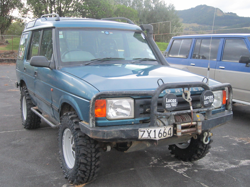

Re: Project 1996 Disco 300tdi
BFG 235/85 16's. I also have a set of 33" Silverstone MT-117's on modified Disco Rims. Reversed centres with 30mm offset.
2" OME Lift, Camel cut albiet fairly rough plus a bit cut from the rear of the front guard as well. The best investment to stop rubbing was Extended bump stops.
I also have 30mm lathed alloy blocks under the springs on top of the mounting plates.
Also now OME shocks switched to +2" Terrafirma Heavy Duty after breaking a couple of the OME shocks. With these i ahve had the break hoses all extended 2"
Switching the BFG's soon for 285/75R16 which will also go on similar modified rims as above.
I also have custom front bar and rear, plus custom rock sliders, rear bar and sliders made by a guy in Auckland Land Rover club.
Self made rear storage which is adequate for now with a shelf and space for 2 drawers and a Waeco fridge freezer, 2nd battery feeding the Waeco and several rear power outlets.
Twin ARB Lockers, ARB Compressor (Although not good enough for air tools) and 9500 Come Up Winch all fitted a couple of yrs ago.
