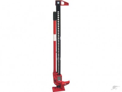

http://www.trademe.co.nz/motors/car-par ... 946650.htm
They come up on trademe often for $1 reserve from Topmaq.

cheers mate :D so you think this should be what i need for the rivers here in chch? instead of a winch

Post by WRNGLR »
waka wrote:cheers mate :D so you think this should be what i need for the rivers here in chch? instead of a winch
these are good for lifting wheels to put stuff under to gain traction ( more rocks or logs etc for height under diffs if you get bellied). also called a farm jack at some places.
Areal good accessory to go with it is this thing called a lift mate
http://www.4wdbits.co.nz/ProductDetails.aspx?productID=4030, can lift the wheel without lifting the body first, or this but you run the risk of wrecking ya bumpers etchttp://www.4wdbits.co.nz/ProductDetails.aspx?productID=4031
hope this helps some

great just bought the high lift jack that juz suggested that was on trademe. Purchased it for $77 thought this is a good start and obviously essential just need to learn how to use it.

good move mate watch ya fingers when ya disengage lever to let it down.

The most important things to remember with a hi lift jack are, Always have the handle in an upright position before clicking the lever down to enable you to jack downwards, and NEVER have your head or body above the handle when operating it. If you slip or let go of the handle it comes up with a lot of force behind it.
I have been laid out by the handle coming out of my grip while using the jack.

Worse than tyson :lol: I lifted the end of a 40ft shipping container with mine the other day, if they decide to do the funky chicken on you the handle looks to move at almost light speed.

I can vouch for that, mine had a wire clip to hold the handle up against the spine, but long since bent out of shape and no longer 'clips', and when that unforeseen gust of wind blows the handle down off its sitting position thats all the force it takes to release the pin and inertia will do the rest with a great force until the weight comes off the jack. I generally try not to leave the mechanism in the down setting anyway, and rest the handle at the point where it contacts the lift mechanism so it cant fall down and release it. But best bet is to use the clip if it came with one or fashion a big rubber band from a tyre tube or something to hold the handle upright. I see you can get a proper hi-lift branded 'handle isolator', dont know how well they work but probably a lot more expensive than a bit of old inner-tube :P They also make a good short haul emergency winch when used with a drag chain setup correctly, but it is F***EN hard work (i know that from experience too haha).
