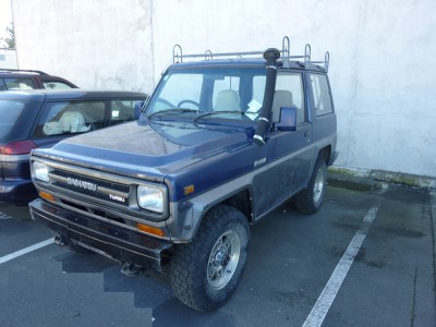

So, new member and all, got this (1989 F70 DL-51) around easter and this sites been really good so far but I've reached a point where I figured I should stop lurking and sign up!
Based in Chch and it's just to get me to hunting spots really so it probably won't get heaps done to it.
Spent about a day under it with degreaser and a water blaster to start with then replaced the fluids, belts, brakes.
Found the timing belt cover has a hole in it so haven't changed the timing belt yet want to replace or repair at the same time.
Gear box and tranfer case had a fair amount of metal shavings on the drain plugs and it has the second gear issue, not entirely sure about what I can do here. Would like to find a second hand one to rebuild prior to this one giving up but not even sure if you can get parts to rebuild.
Snorkel kit to fit it seemed to be non-existant so did one myself. Re-piped the diff breathers. Planning on putting a new exhaust on and have some half worn kl-71s in the same size for now until I decide what I'll do suspension wise.
Would like to be able to lock a diff for those tricky spots but like the snorkel doesn't seem I've got many options!
