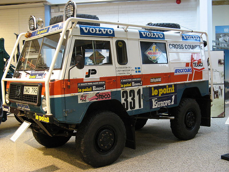

saw this on a tumblr site the other day. bit of volvo p0rn i suppose!
- geckoadventure
- Posts: 550
- Joined: Sun Nov 29, 2009 12:30 pm
- Location: Malaysia
Re: Volvo C304 4x4 Build/Restoration
Oh My that's stunning.
I'm putting 27" Trepadors on ours.

I have this pic stored away I want to see how close mine looks to this at the end.
