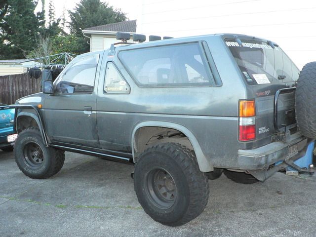

Posts: 329
Joined: Tue Feb 06, 2007 12:00 pm
Location: Papatoetoe Auckland
Re: Suspension lift
Post by DEATH_INC »
New stuff... rock sliders :D
Just gotta trim the exhaust down and they're done.
