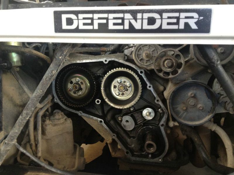

Turned into a bit of a mission doing the cam belt...turns out my 300tdi hasn't has the crank pulley changed over (early 300tdi's should have all had this done). Mine was the old setup...with the lip on the tensioner, rather than the pulley. Thankfully http://landroverspares.co.nz came to the rescue, and sent overnight the new seals/crank pulley...cheers Rex

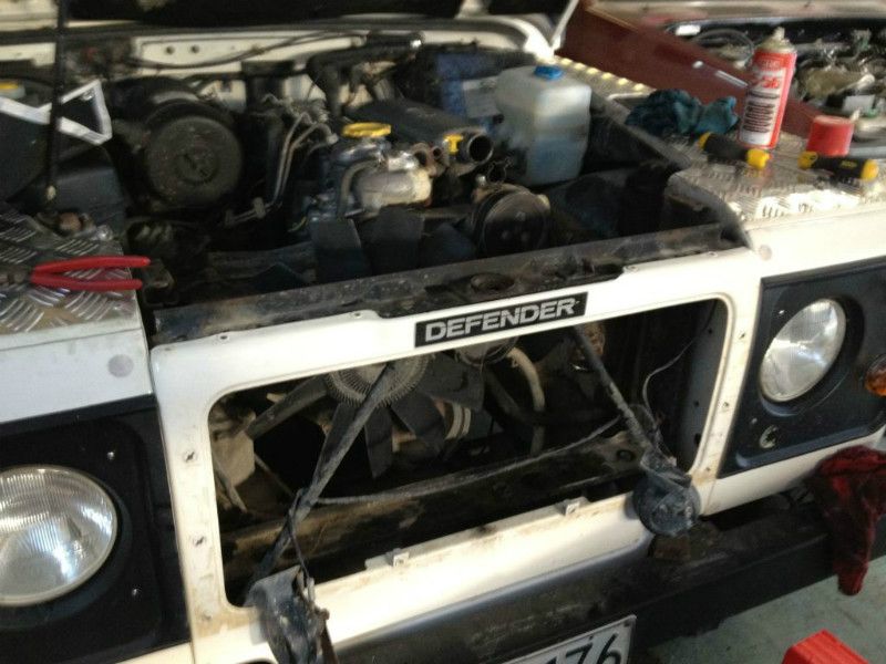

Radiator out...
hoses off
timing cover, fan etc out...

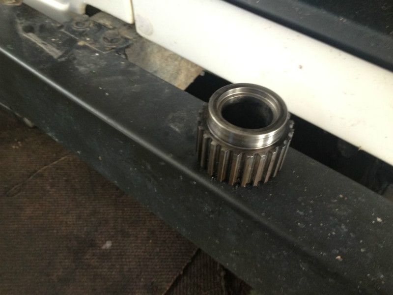

the offending part...should really have been done years ago, the 110 had full service history up til 130,000kms...so it should have been picked up

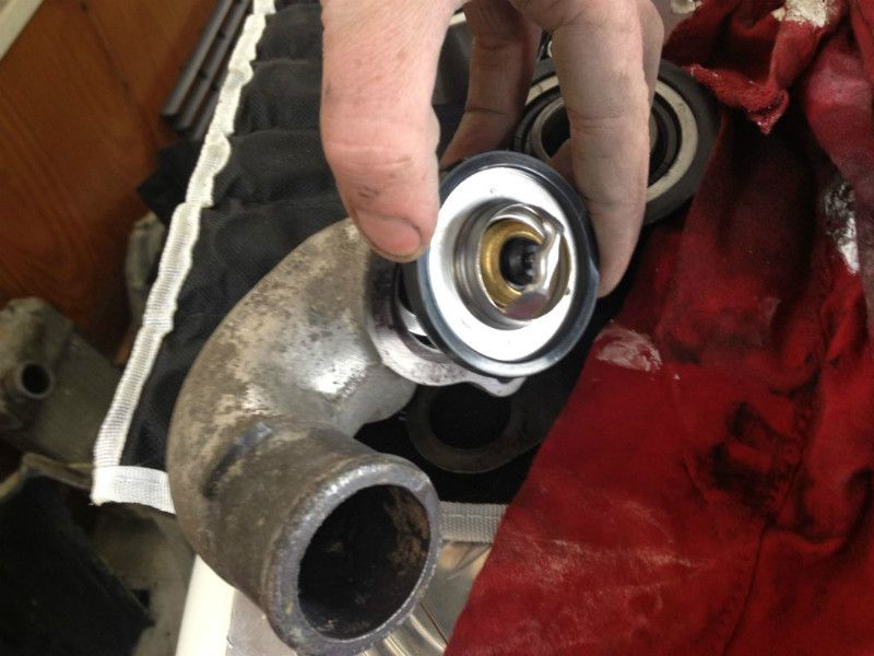

new thermostat...maybe the heater will function better now...

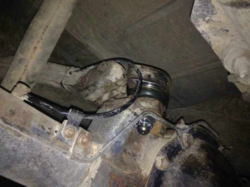

A Frame balljoint...mongrel to get the new joint in, had to whip into a mechanics and use a press

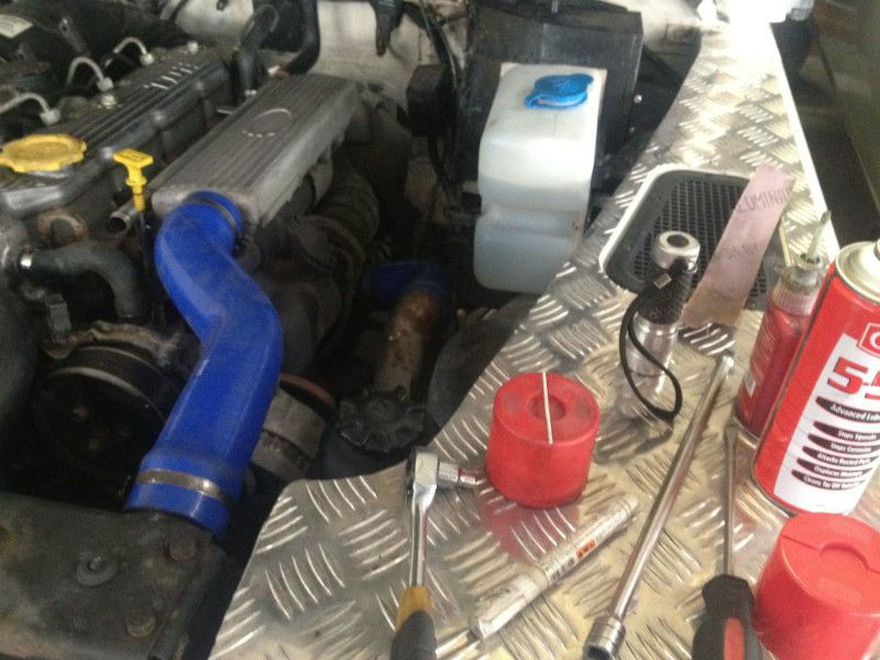

nice new hoses
finally back together, oils changed, filters changed...and cleaned out the rear diesel water trap/sedimentor...what a mess inside that
