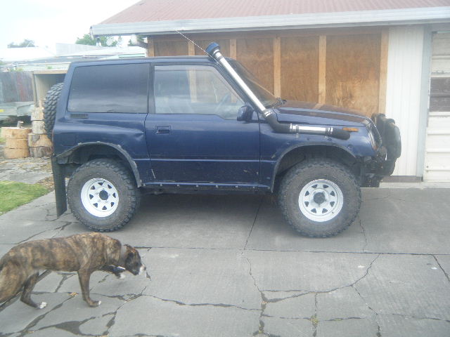

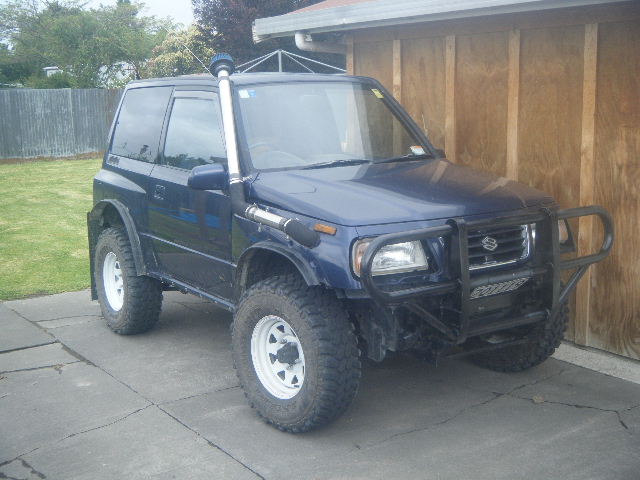

this is the start of mine its slowley geting there

butcherboy wrote:this is the start of mine its slowley geting there
Looks good!
What have you done so far?
Looks good!
2 inch body lift 35mm suspension lift replaced the front brakes with smaller ones for the 15 inch rims and ripped all the plastics and bits i dont need off, its a v6 so thats why it didnt get the 3inch lift kit
