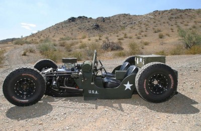

Not really keen on a std trayback so have been trawling for ideas and an old stepside bed (chevy c10 style) might be an idea. Have to make one from scratch but it could work with the right guards and a tojo tailgate to finish it off.
Gotta run guards though as it will be too young to go fenderless, which is fine as the ifs fronts are ugly so have to hide them somehow. Makes fitting headers that come out over the guards hard to sort though...

tort sum uz fullas wood lick ths pixture.
I dunt. That is all.
