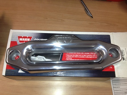

Ordered a warn winch cover and warn hawse fairlead from the states, so can't wait for these to arrive. A plasma rope would go nicely on it.

New Warn Hawse fairlead arrived today. it's purrrfffect, exceptional quality. Glad I got one of these rather than the crap sold in NZ for the same price.
