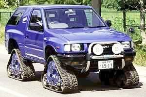

Photos?
SASed Isuzu Mu - hilux diffs, Rears up front, disc brake conversion, ifs hub swap, crossover steering, and legal!!!!
Dirtydog
Posts: 1788
Location: Gore, Southland
Re: ute chopped mu?
Post by Dirtydog »
not my photos but hey, the look cool (well two of them anyway)
