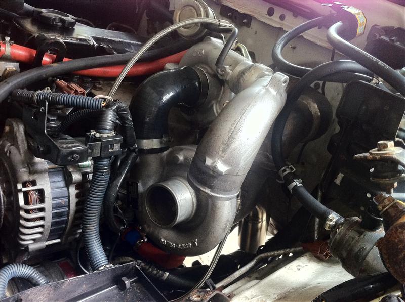

Well not much going on as its holidays and I am drinking.
But did manage to get hold of a sump guard for the truck the trick alloy ones.
Also got some more pics of my mates qd32 twin turbo
Re: The wax terrano
I have been playing with my mates qd32 twin turbo. Its insanely fast, so much that cars struggle with it off the lights and really have no hope once its rolling. Its really upset me as the terrano feels so slow now
Re: The wax terrano
Bit more motivation to gets yours in then?!
Whats he done for fueling? Bigger internals in the pump like your setup? I'm guessing hes got a front mount inty? (can't see piping in pics, so I'm a guessing thats where it goes)
