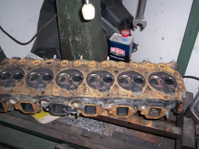

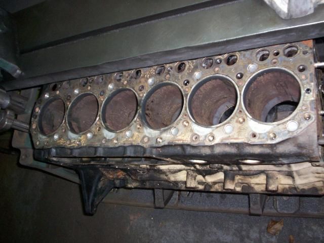

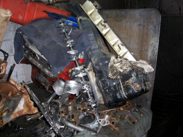

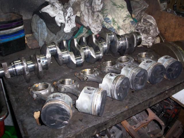

block ex hot tank
one cyl head
pistons with stuck rings and the crank
and all the other bits

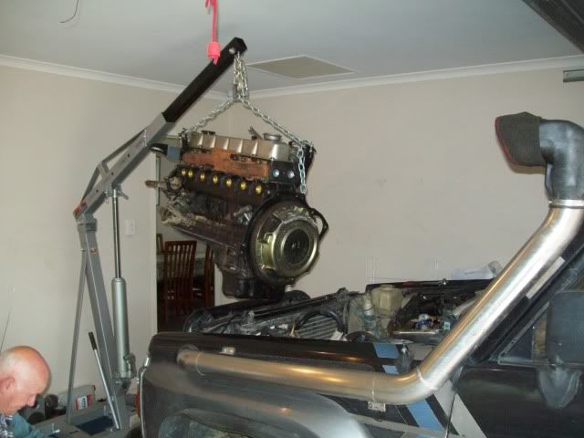

Re: engine parts for TD 4.2
yay pick up engine tomorrow :D

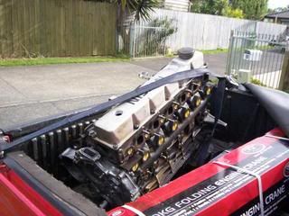

now he phoned me today , pick it up monday :D
24 weeks for a engine build

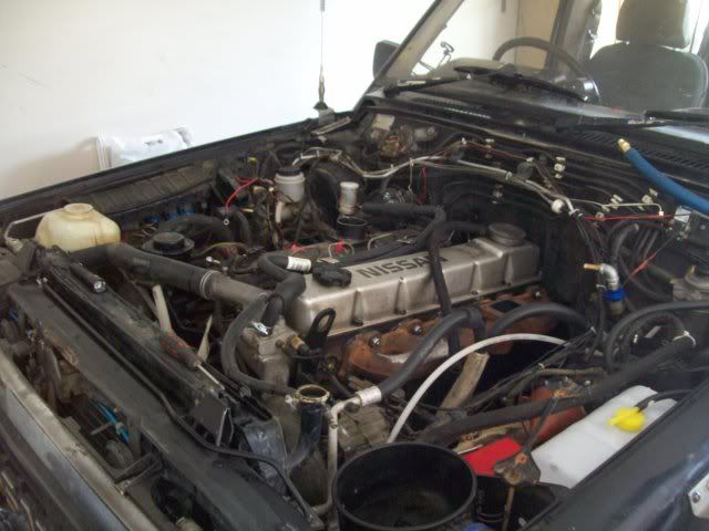

forgot 22mm long reach socket for injectors, oil in, just turbo, its lines and dump pipe ,batteries, water then fire it up.

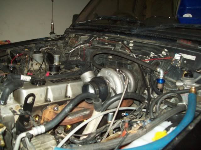

turbo is on with oil line aren'T cut cable ties sharp
keepwalkn
Posts: 44
Joined: Mon Nov 05, 2012 8:31 pm
Post by keepwalkn »
That turbo is gunna be laggy.
Looks like .86 hotside ;\
Got A/R.70 on it will let you know if your right or wrong :roll:
