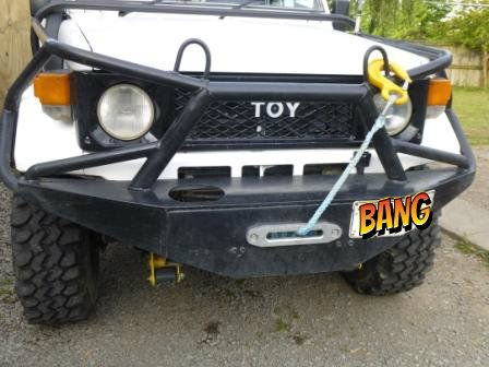

Hi ive just been through this issue with my PTO on my MWB cruiser weighing up approach angle etc etc i found i couldnt lift or push the pto any further back into the truck without major mod needed i decided to lift the unit approx 20mm and built a bar tight around it to get maximum approach in the end a end up getting caught on shackles before winch bar! It has prety much never been an issue for me. Also you retain the factory pto shaft angles, The straighter the better i rekon less force through UJs.
Re: PTO vs Electric winch?
Hi Bruiser, that sounds like a good option, im not to keen on playing with my shafts either.
Have you got any photos of the setup by any chance?
Here is a couple of the setup ive done i just rebuilt whole system from Transfer case right through and am running the Dynema rope managed to get about 34mtrs on the drum.
Hope these help out
]Hope these help out
Sweet thanks, that looks good, ill have a decent look at mine this weekend.
