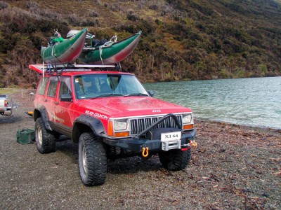

I have a 4.5" lift with a drop TC ,i didn't have any problem with it . if you are in CHCH you are welcome to have a look at :D ..

Brother your Cherokee looks mean I like it, tried to post a pic of mine and failed, have you changed the diff ratio for the 33"s ?

hemiben04 wrote:Brother your Cherokee looks mean I like it, tried to post a pic of mine and failed, have you changed the diff ratio for the 33"s ?
Not yet i'm on 3.55 , lost a bit of power but i don't care... looking for a dana 44 or ford 8.8 and move on to 4.56 ...
