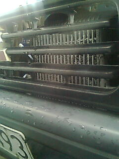

the intercooler behind the grill

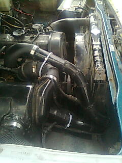

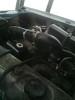

the cool intercooler pipe going into the intake manifold.

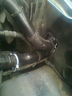

the hole in the front panel beside the radiator i expanded to fit the intercooler pipes
where the hot charged intercooler pipe and the cool retern intercooler pipe go to the front mount

I was going to run a top mount but i thought no everyone else does that so i put a front mount on instead. after a long drive i can put my face on the cool pipe and i can hardly even touch the hot side with my hand even, so its working well. to help with the under bonnet temps i put a bonnet scoop on anyway where a top mount might of sat to trick people. and it does, they ask wheres the intercooler and i jst point to the pipes going out the front. I fell in love with my truck again once i put the intercooler on, i has plenty of power now cause i had just done a burnout up my drive way with the muddies on lol. :lol: if you want to know any more feel more than welcome to ask for anythng. 8)

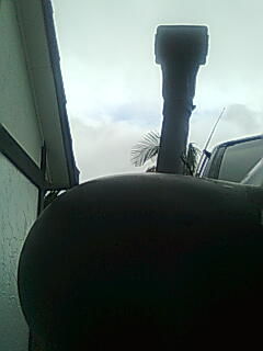

the snorkel sitting high and proud on the side

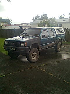

heres my pretty standard 92 l200 with a 4d56 engine non turbo only "mods" ive done so far is a new set of mud tyres haha. not quite sure what to do with her yet as im not that good mechanicaly wise and being a student i never have enough money :lol:

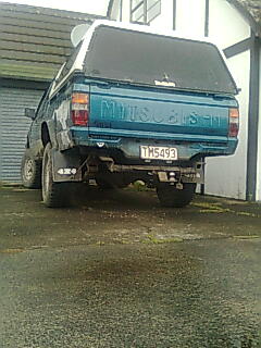

l200 with not a straight panel on it

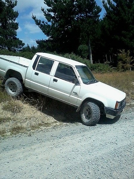

I'm new to this but I have a L200 that's getting some "treatment"
It has had a bit of a lift with the torsion bars tweaked and some coil springs added to the rear, I've fitted some wider offset rims with 31" maxxis mudders.
The aircon is being canibalised to be used as a compressor so I can run low pressures in the tyres whilst out playing and still make it home in one bit :)
Alloy bash plates and some exhaust mods underneath are on the list to.
