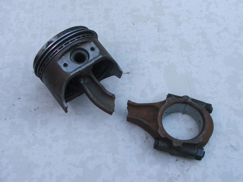

It's very unlikely that any of the electrics are stuffed as water doesn't really break anything. Electrics just tend not to work while they are filled with water. High voltage type stuff like the ignition system is most at risk. Take everything that is not sealed apart and dry it very well, should live again.
Mechanical things like engines on the other hand are much more at risk. The main problem being that water doesn't compress very well, so what happens is you get some water into the air inlet, this gets "sucked" into the combustion chamber and when the piston moves up to compress it, it cannot. The usual result at his point if you are very lucky is that the engine just stalls rapidly, if you are unlucky then the connecting rods bend. I don't think the valves will bend, but someone might correct me.

When I watered mine I bent 2 connecting rods out of 6. I rebuilt the engine with second hand rods, new bearings and rings and it runs ok. My advice would be to replace the engine with a good low km unit if you can't do the rebuild yourself as the cost of a rebuild I suspect will be quite high.
