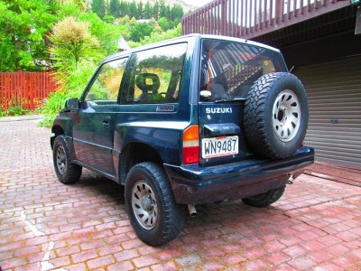

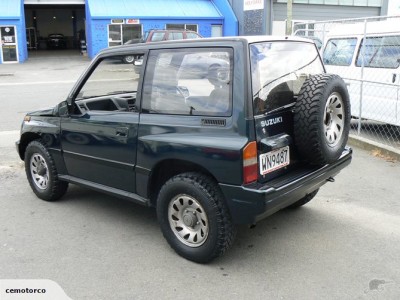

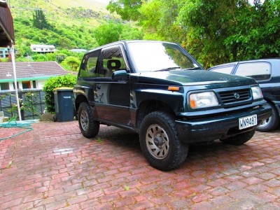

This is how it sits at the moment. The white roof is a big sticker... Thinking it could be there because the roof may be faded so not sure if I want to take it off haha.
I removed the plastic side skirts to find a small amount of paint rubbed off with a little surface rust. Thinking of just getting it sanded and painted black.

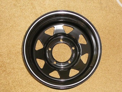

Got a big delivery today which is always a bit exciting :D
15x8, -20 offset
oneinkedgeek
Posts: 118
Joined: Wed Jul 18, 2012 10:49 pm
Re: Suzuki Escudo
Post by oneinkedgeek »
jimmyf8 wrote:Got a big delivery today which is always a bit exciting :D
15x8, -20 offset
Yeah its always good having stuff turn up, Im keen to see those things fitted. I tried on thoes exact same wheels on mine and man i couldnt beleive how much they stuck out past the guards. I ended up going with the mudbits ones which were -15 i think, and even those stick miles out. Youll need to get some flares sorted for WOF.

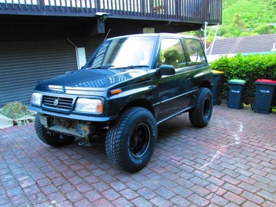

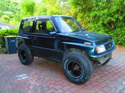

2 inch body lift is in :D
Keen to lift the front bumper in line with the body and lift the fuel tank too. Any advice on how to do that would be awesome!
Couple of photos.

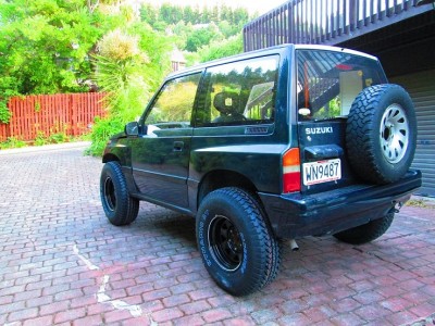

31s are on. Plenty of rubbing! Looks tougher tho :D . Any ideas on how to make it a bit more driveable until I get the suspension lift?
zukmeista
Posts: 2380
Re: Suzuki Escudo
Post by zukmeista »
Hammer. :lol:

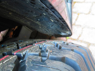

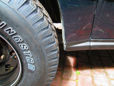

So far its the front wheels rubbing when i go to turn. The back of each front wheel rubs on the inside of the guard. As you can see there isn't a lot of room.
The rubbing occurs at the bottom of the inner guard. In the top picture you can see the mark where it rubbed at the bottom on the plastic.

Heres a pic of what I got done to the sills after removing those plastic crap collectors

Ah I see, common problem with larger off set wheels.
