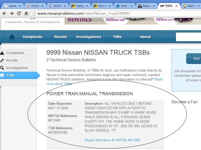

VERY good point, I overlooked that completely. Did some more looking into it, looks like another TSB was issued for the FS5W71C - details are below, also a link if you want to purchase the TSB ($12 US or something)
The TSB was issued for the US Domestic Market, not sure if that makes a difference...
When my one eventually grenades I think I will go the wax route and put the misty box in, apparently Z Cars run those w/ 500+hp
--- QUOTE ---
1986.5-1996 4WD TRUCK FS5W71C MANUAL TRANSMISSION WHINE NOISE ON ACCELERATION
The amended version of NTB97-018a updates information in the Applied Vehicle, Service Procedure and Parts information sections. Please discard previous copies of NTB97-018 and NTB97-018a.
APPLIED VEHICLE(S): 1986.5-1996 Truck (D21/KA24E, Z24I eng.) 4WD only
APPLIED VIN(S): All vehicles built before 1N6SD11S8VC327106
APPLIED DATE(S): All vehicles built before October 15, 1996
APPLIED TRANSMISSION #(S): FS5W71C-006
SERVICE INFORMATION
If a FS5W71C transmission exhibits a whine noise while driving in all forward gears except 4th, the cause may be lack of lubrication to the main and counter drive gears on acceleration and/or climbing. The whine noise is more pronounced in 1st, 2nd or 3rd gears at slow speeds.
SERVICE PROCEDURE
[Transmission rebuilding info skipped]
Note the following changes to the transmission case and fluid levels:
- The transmission oil level is increased from 4.0l to 4.9l +/-0.1l (4.2qt to 5.2qt +/-0.1qt) to prevent lack of lubrication when climbing hills
- The oil filler plug is relocated to compensate for the increased oil level.
[Parts and claims tables skipped]
--- UNQUOTE ---

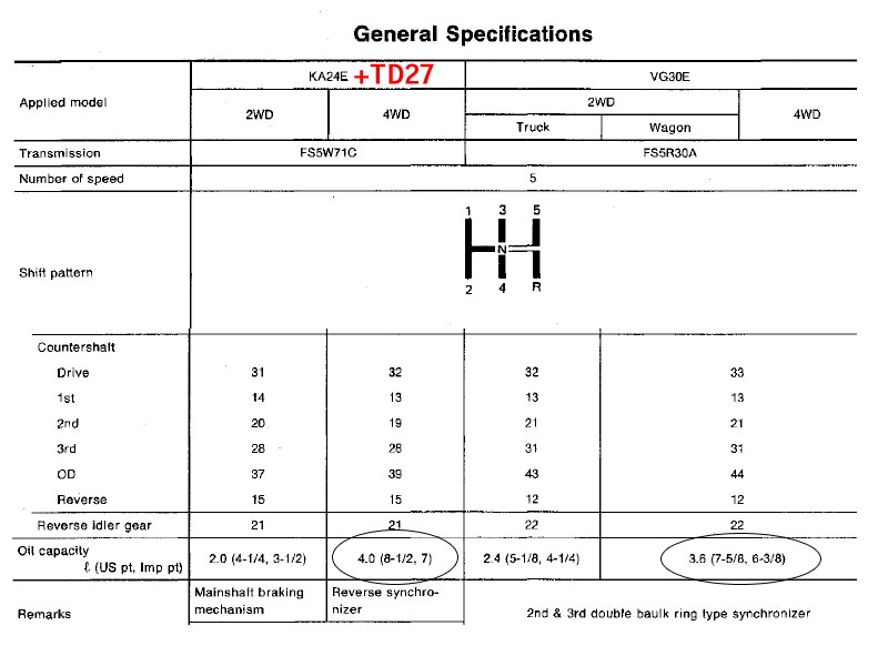

Also heres the factory service manual from 1992 showing oil capacities for each gearbox - 4 litres for the FS5W71C and 3.6 litres for the FS5R30A. This is consistent with the TSBs that came a couple of years later, advising to increase capacity by 0.9 and 1.5l respectively.
