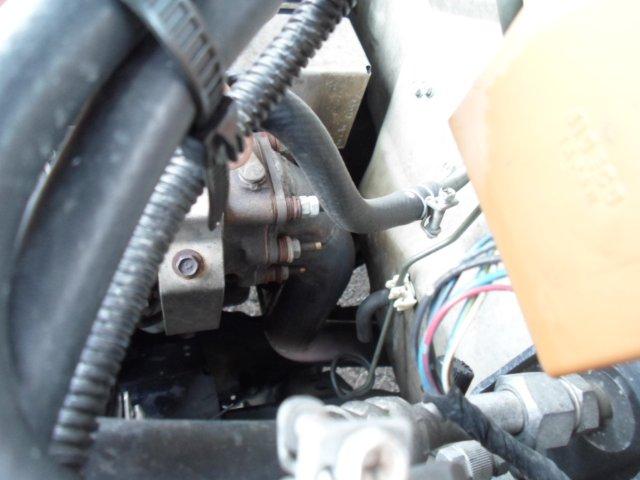

Nice wags (same colour as mine
Dump pipe looks tidy done. You make out of a 2.5" mandrel bend?
Re: Another Newby with a another Terrano
Yip 2.5" mandrel bends and heavy wall exhaust tube, got the flange hydro cut from the gasket outline. Stiched an offcut bend ontop for the wastegate gasses so it flows well. Ended up heating the pipe and panelbeating it abit so its easier to get the nuts done up. Was supposed to make a proper spacer up for the nuts but it was getting late so ended up using washers, that was 2 months ago now!
still it dosent leak but better finish the job at somestage.
