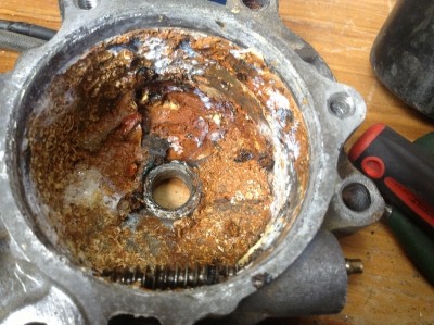

Hi All,
Anyone know if these can be recon'd or have one that works. Toyota want 2k for one. I have two stuffed ones, one from river water and one from salt water ( sig, looks like that TC was seized due to salt water ingress)
See pics below

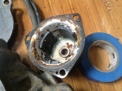

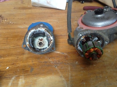

This is what the salt water one looks like

There is a new diff lock motor on trademe at the mo, the motor itself is the same, so if it's just the motor that's stuffed that would be the cheapest fix right now, have been told the motors are the same.
You'll need to take yours off and check the worm gear etc are all ok first though.
