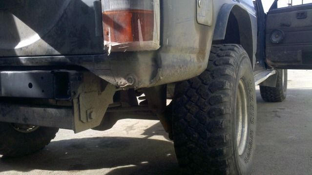

Well have decided to put my gradual build of our lwb low roof on here.
When got it it was a plain jane auto. Don't think it had ever been on anything harder than a gravel road. :lol:

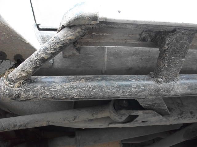

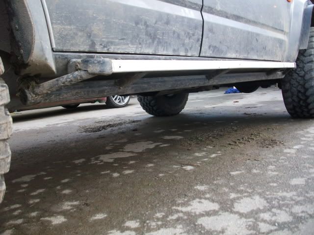

Since then i've been busy in the workshop building bull bars and sliders.
Have also fitted a 12000lb runva,33s,cruiser frnt springs and kings in the rear(My front ones got pinched :evil: )
Sway bars been removed,and have fitted a reversing light.
Plans are to keep doing things to improve it offroad while still keeping it on the road so will be a slow prossess.

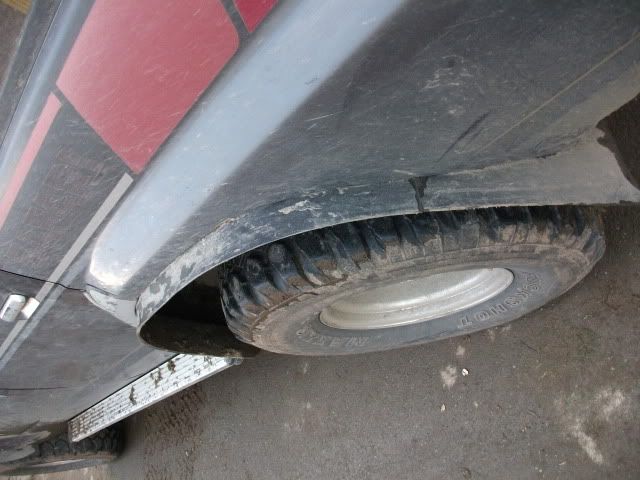

Imagegot rid of the weak plastic flares and replaced with good old conveyor belt
Imagerear end of side steps
Imageside veiw of steps

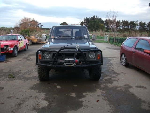

Imagefront bar.reckon it needs another bar under headlights,any sugestions

forgot to add. one of the focuses of this build will to do as much as poss without spending coin. Am a great beliver of why pay somone to do what i can do or learn to do.
All bar work is made with an old arc welder and a grinder. Pipe is leftover stuff from building sites. Sliders were made out of an old trailer and a gate :lol:.

Couple of questions. Has anyone raised the rear shock mounts before? cause man they hang down. If i do it do i need to cert it?
Also does the diff shave need to be cert'd.
Doing those mod as most of the club comps down here have a tyre size restriction (33s)

Got rear bar made and fitted along with a quarter panel chop.
