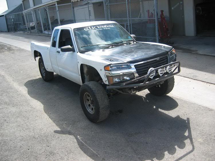

so what will this mean to our bullbar fitment?
where it states not to slope forward.
the bar i was going to build leans forward like the baja comp trucks.
it wouldn't look to good at at 90 degrees standing vertical.
looks like this ->
http://i212.photobucket.com/albums/cc91 ... prerun.jpg
looks like this ->

Fail unless you have it certed.
silveradoman wrote:so what will this mean to our bullbar fitment?
looks like this ->

whats the difference between that and an arb bar (impact wise ) or the old fj45 railway irons
Re: WOF Regulations
Re Bulllbar sloping forward ..it not allowed
See
2-1 External projections
c, slopes forward, unless this is necessary to fit the contours of the vehicle
yours slopes forward ...FAIL.
See
