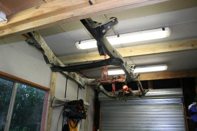

Just for sh$ts and giggles here is a photo of the chassis flying.....
Its supported at three points and tied off with tie down straps...
