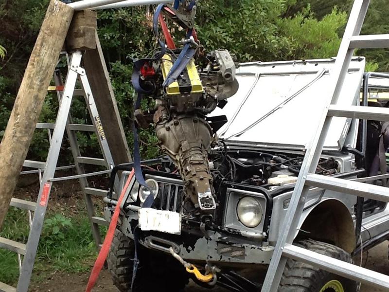

After much saving and searching i decided to go with a nissan 15 silvia.
Found a half cut from japan for resonable price and only 87,000ks on the clock.
Its a SR20det vvt blacktop with 184kw with a 6 speed manual so should fly

My problem now is that the 4age and box was about 1300mm long. And the SR20det+6speed is 1550. So basicly i need to extend my wheel base a bit to fit the new engine and with the extra power a longer wheel base is a good idea i think.

Starting up the half cut hooked up to the jeep for fuel pump. Sounds mean. Now to get it all out and in the Suzy.
Re: Suzuki+4age+Hilux Axels+coils+Exo Cage
After all tested and running started stripping it all out slowly labeling everything i disconnected. So so many wires...
