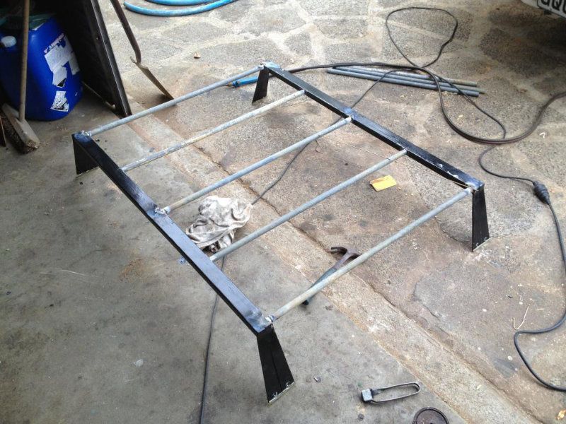

So far I've built the roof racks, fitted a safari tent & built a ladder to access the forward rack where I'll put a tray.

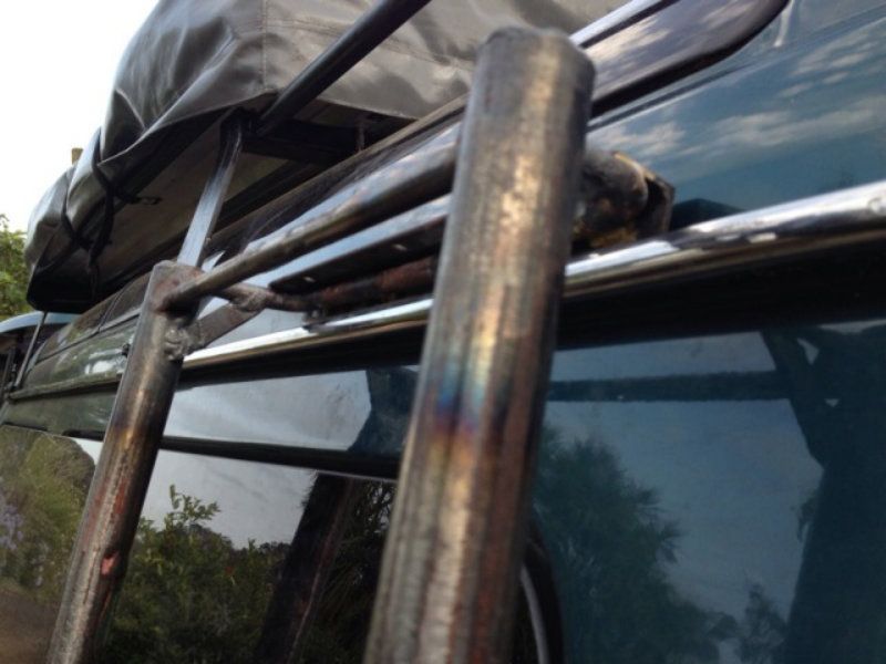

Here's some pics of the work so far, will add more pics as I make progress over time.
As it was when I got it
Rack and tent setup

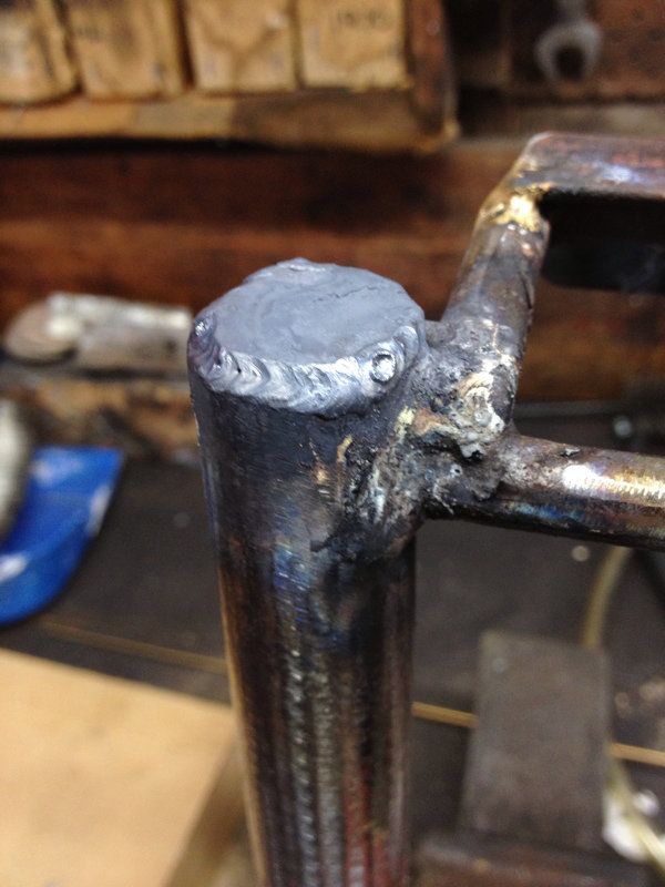

Building the ladder.

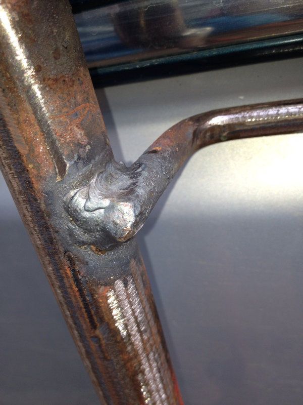

The ladder started life as an old painters ladder I found in the barn, it was quicker to cut it up and modify it than to start from scratch.
It's all painted up and padded now but I dont have a pic yet since I cant mount it properly until I sort a strap out for the bottom to secure it.

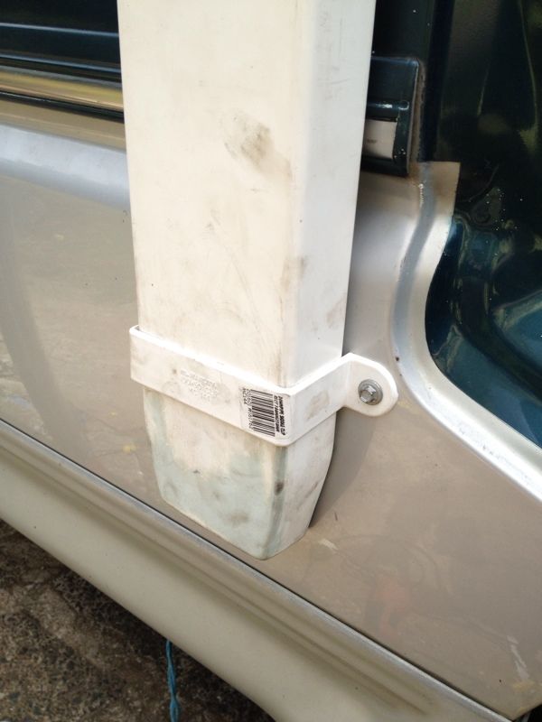

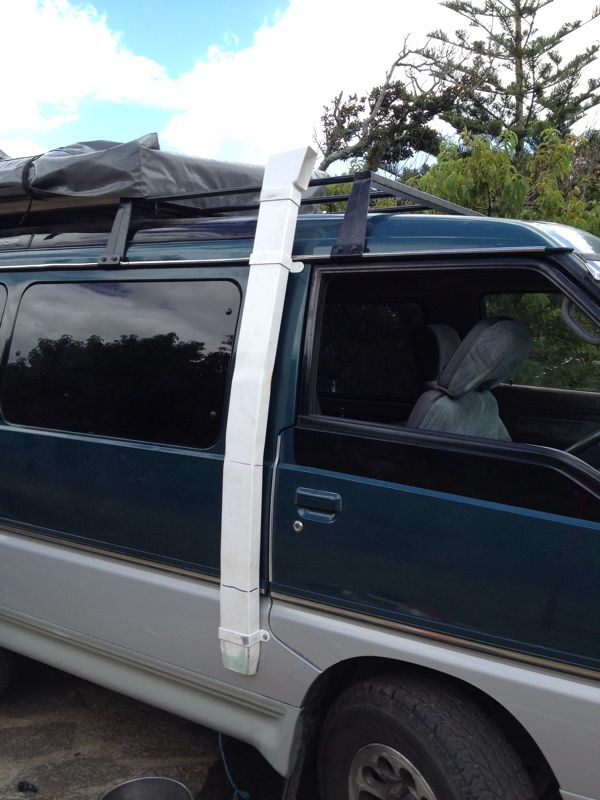

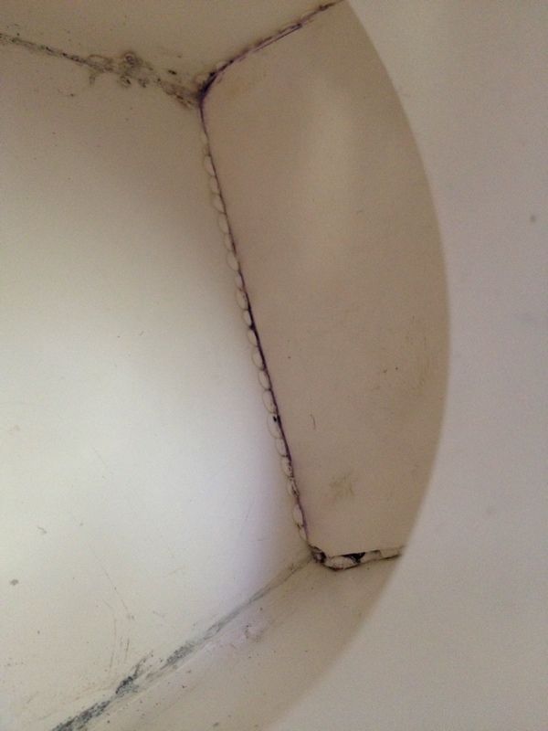

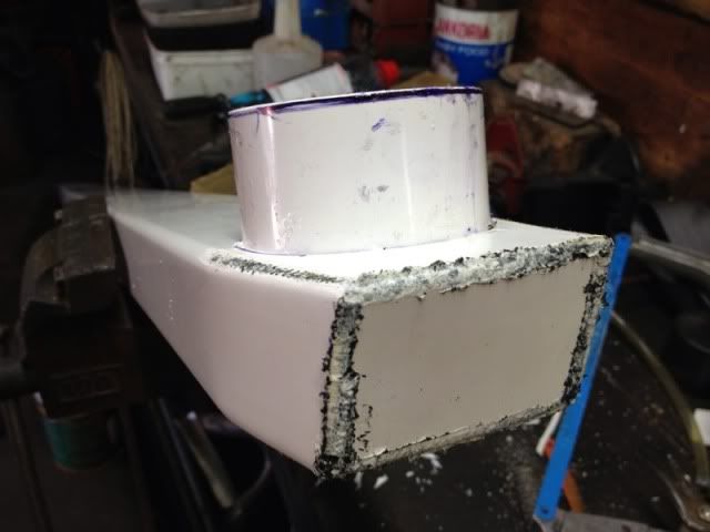

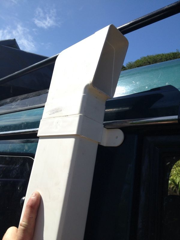

Did a bit more on my ghetto snorkel. Still got a bit to do before it can get fitted.
It's made of rectangular downpipe. I had to plastic weld up a junction at the end as Marley don't make a rectangle into round right angle.
Took the van on a 600km round trip over the weekend from Auck to Taranaki down the west coast then back up highway 3.

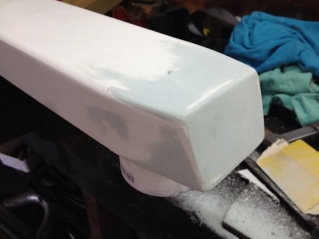

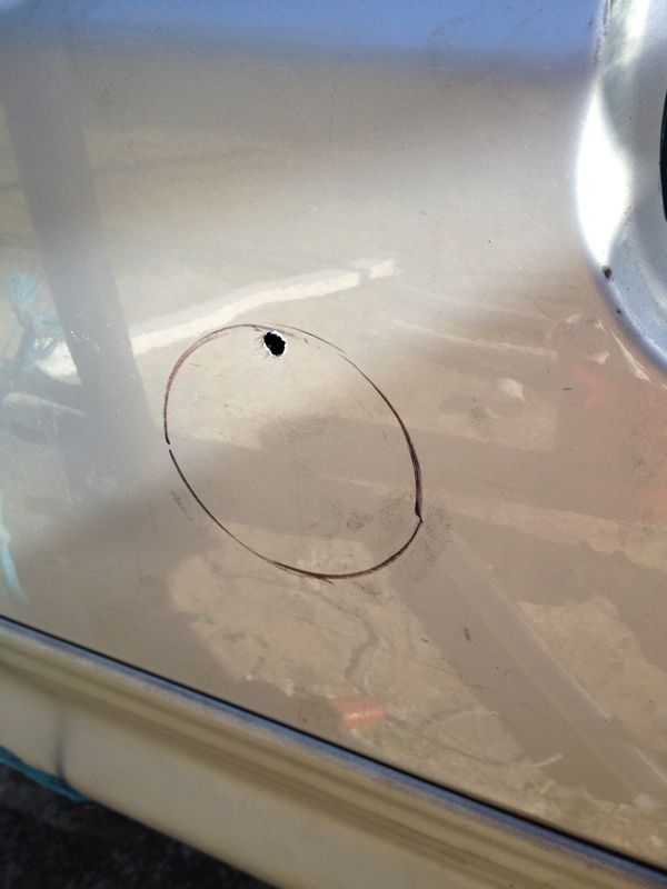

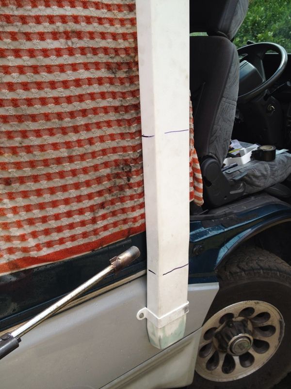

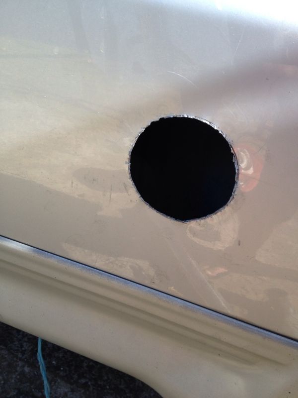

Did a bit more to the snorkel but stil not finished. had one of those shit weekends where everything seems to get in the way and nothing gets achieved.
No going back now....
Tried using a ting tong from ping pong holesaw, lasted less than 30 seconds before it was all burred over so ended up making the hole old skool style...
Fits nice, just gotta sand Marley off the fixture , or maybe leave it there for a laugh :)
Heated the pipe gently with a propane torch while bending it to the shape of the side of the van, nerve wracking but got there in the end. The towel is wet and stops the paint getting scorched.
Now just gotta lower the height of the collector at the top because it's scooping clouds at the moment and paint it. Couldn't find a can of wrinkle so just going mattyB :) Will also make up a gauze insert to keep the bugs out.
Still have to weld the flange into the side of the airfilter can and connect it up but got the tube ready and shouldn't take long.
