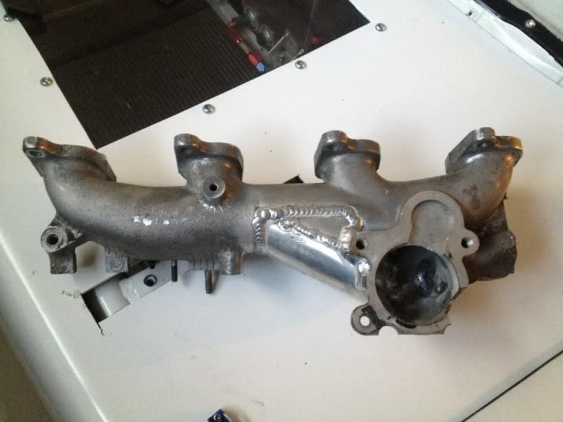

Firstly I have port matched the turbo to manifold and manifold to head.
Today i went through and ported out the intake as well. Small increase in size to suit the intake gasket on the head but the intake manifold has increased by about 10% just to match up with the head. I also welded up the inside of the egr port and ported it into shape.

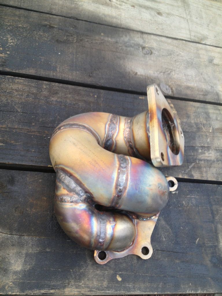

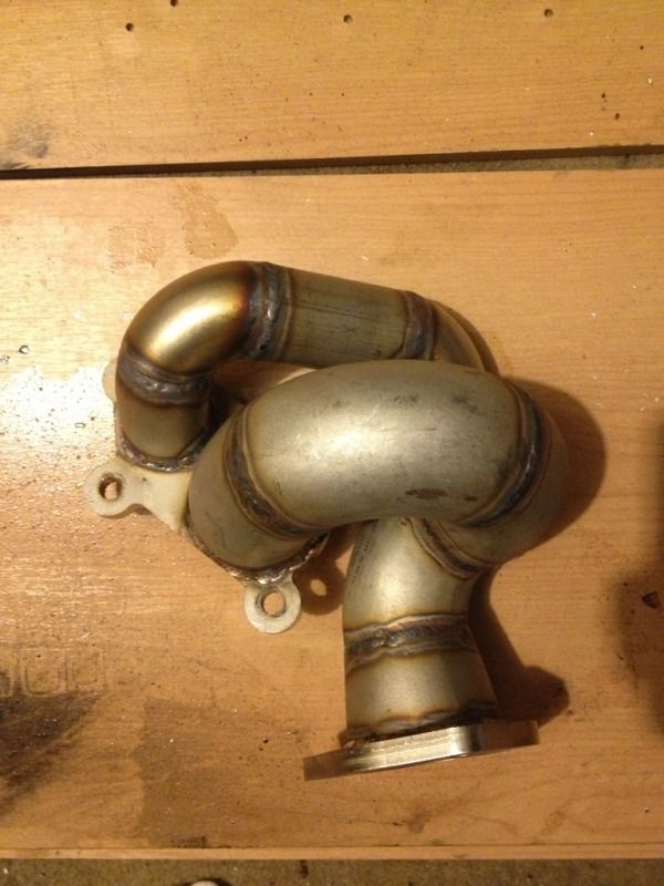

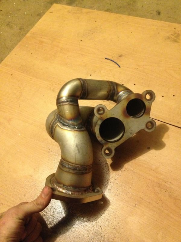

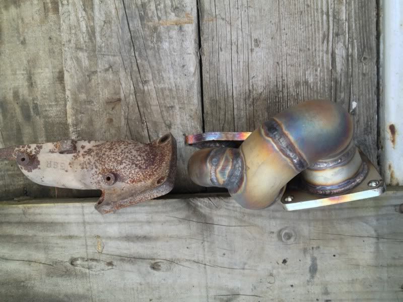

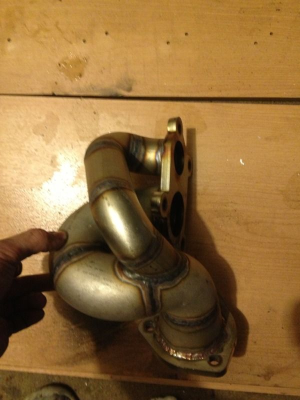

I am waiting for these damn laser cutter to get their acts together and cut my flanges to build 1kz Dump pipes out of stainless steel and thick wall ss bends.

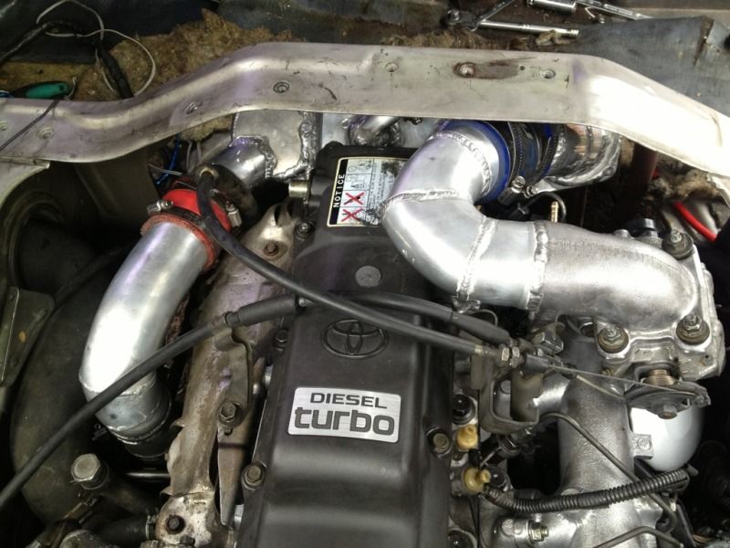

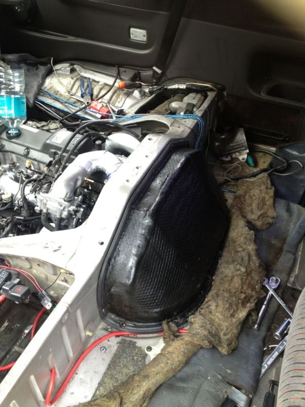

I had already installed a large drag racing water to air intercooler with a Davies craig 115lpm electric water pump front mounted alloy radiator heat exhanger and a 30l water tank to help with water capacity As it does long tow journeys around the country with our drifting. I'll get some better pics of this setup as it all goes back together tomorrow.
