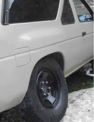

Yeah for the front it doesn't matter as the IFS can only travel so far. I have both front and back sway-bars out. The driving takes a bit of getting used to and don't drive it hard on the road around corners, she isn't a great handler. But offroad its great fun.
I was seriously considering putting the front sway-bar back in and just leaving the back out.
In the back I get much better travel, check this....

Super flex.
