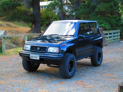

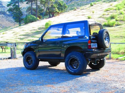

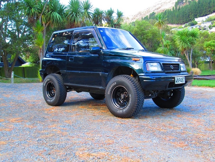

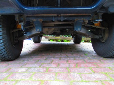

Here is a couple of pics with the kit in and a 2 inch body lift.
Love the kit though. No problem with camber in the front either. Drives sweet!

Looks mean!!!

The FTS kit has no body lift, so bumpers do not get affected
I think this was what he was getting at mate
Re: FTS Lift Kit Help
haha, my bad, didn't see that, as you were
Looks good,
Which way up were the rear control arms fitted?
Any need for 5 door handbrake cables?

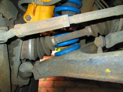

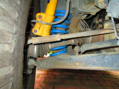

What is limiting the front and rear articulation out of interest. I have ended up with a lot of the components of that kit, together with some spring spacers, body lift, and control arms. Interested to see how the geometry is with the kit as intended. How are the front cv angles? Mine are pretty severe. Plan is to see how they go on my auto box.

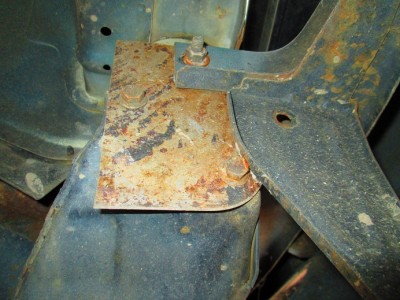

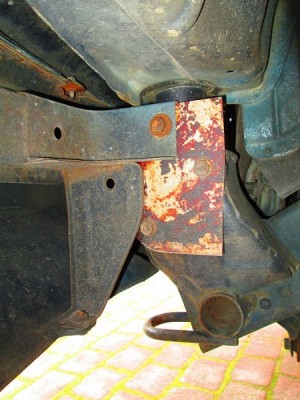

I made a bracket out of an old oven tray to raise the front bumper.
I believe the rear control arms weren't changed.
The TC and GB shifters had to be modified because with the 2 inch body lift and the 1 inch TC drop mount it had the effect of a 3 inch body lift on the shifters.
Haven't had any problem with the handbrake since the kit was installed and its just the standards one.

Nice brackets. I also moved my bumper up and out when I added body lift. The handbrake cables are needed if they limit the articulation at full droop. I thought the control arms came with the kit. Thanks for the photos, looks good. I'm interested in the TC bracket, and seeing how it changes the front diff angle
