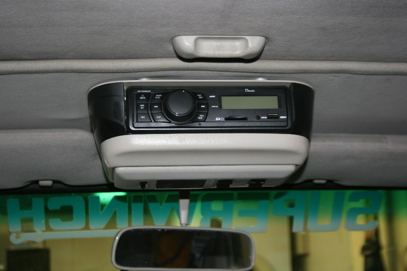

Here are some pics.. (out of a KZJ78 Prado) First one is in the roof, used to have a full din sized CB then put in a smaller PRS / UHF...
Now its sporting a normal car radio...
Used the mount points for interior light / sun roof controls and made a frame...
Then the light / controls attached to the frame...
Moved it after a few years as the mic lead would get in the way....

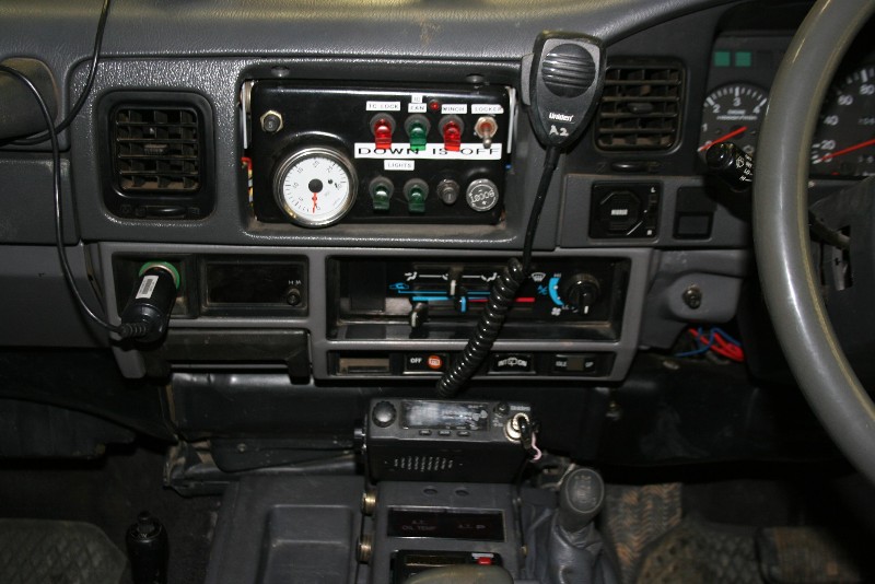

Second pic is the new location of the PRS / UHF which fits in nice between the center console and trans tunnel just forward of the gear lever...
Mic mounted on center console...

That roof mount job looks real good, a real pro job.
