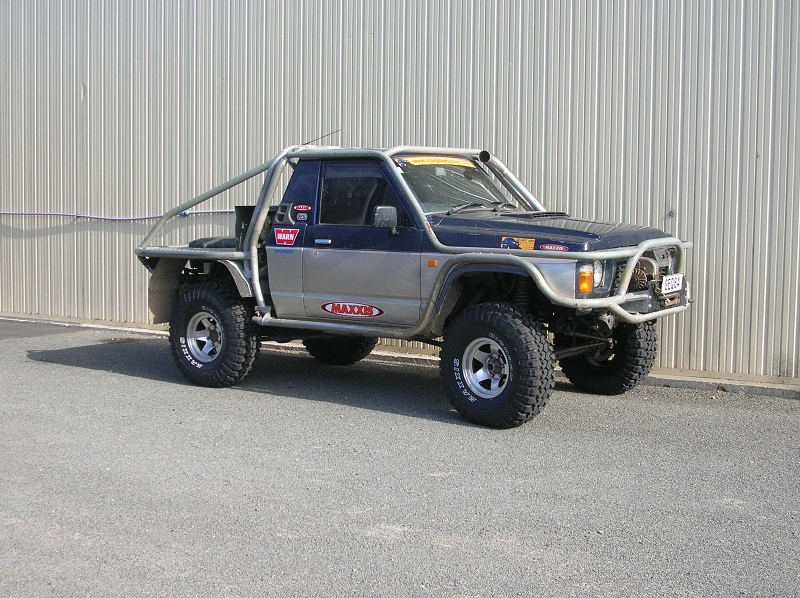

Nissan Safari LWB shortened an VG30DETT fitted.

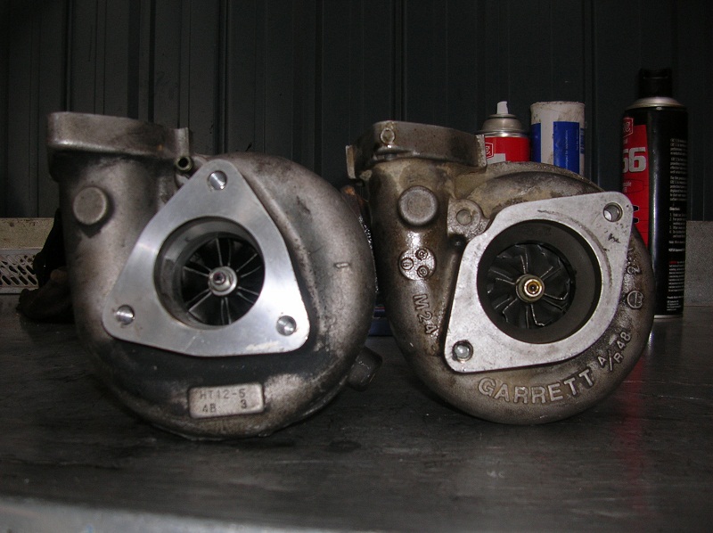

while i had turbos off i decided to take to the heavily restricted exhaust manifolds. how these motors ever breathed/flowed well i'll never know. few hours on a die grinder fixed that.

just stumbled across your build, awesome truck and interesting choice of engine i have had 3 of these engines and they have so much power...What i have learnt after years of owning them is standard turbos don't like much more than 12 psi, main bearing need very clean oil, i changed mine every 3500 - 5000km (piece of mind after 2 rebuilds due to bearing pick up) and as long as they stay cool they will be quite reliable (like most engines).
A guy in auckland called "slashman" (i have contact if you want) is a VG30DETT guru and does ECU mod to make a 350 - 400 hp (stock internals do not take much more)
Re: Nissan Safari LWB shortened an VG30DETT fitted.
This motor i flushed it about 4 times before i started driving it hard as it had ticky lifters an wanted to start running it on good oil.
yes these engine certainly have a lot of pony's for the size motor with a few easy mods. i love it. pretty good to drive round on club trips an camping an not to hard on gas but wen ya need to play with the big boys ya just lay ya foot into it an man things get exciting.
I change the turbos to steel shaft ball bearing types, far more reliable.
And running 14psi now.
Im planing to one day get it to one of those guys like slashman or another guy i heard of Glen at "the Lab" heard hes good. an get it chipped an tuned better. it has a Bliz ecu on it now an thats cranked things up a bit also.

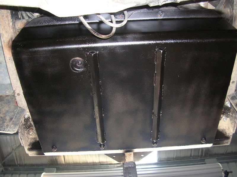

Been staring to use more an more off road and was stressed that the big rocks we sometime drive over will end up reducing the volume of my fuel tank. and being a 90L one they hang a bit lower so made a 5mm steel plate under it. now i can drive up riverbeds, steep banks, thru deep ditchs an off steep ledges an not worry.
thats a mean truck, and you sure that plate is thick enough to protect the tank???
that would almost stop bullets going through it lmao

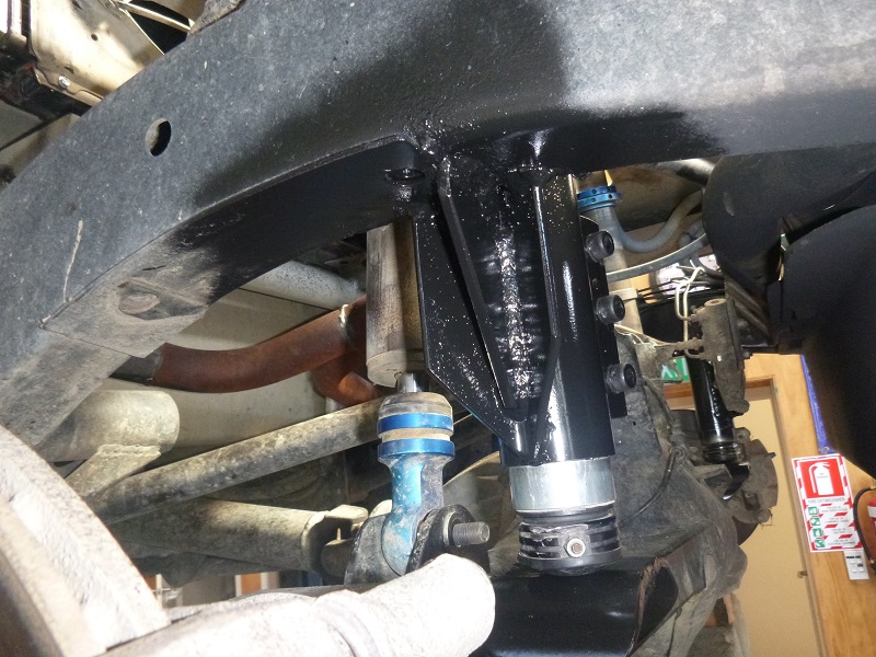

Have been doing a little bit of upgrading.
have now put the Fox 4'' bump stops into the rear and fitted new Radflow 3'' to the front.
Allowing me to bring height down an better articulation without hitting bump stops so soon.
