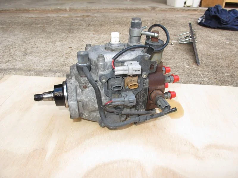

Okay sweet. Will give that a go. The injector pump is another thing I don't know where it is
. Is this what it looks like?: http://forum.ih8mud.com/attachment.php? ... 1322273698

Yep that is a 1kzte injector pump like you will have.
They don't have the adjustable screw like people always say they do. They have a spill valve
The none EFI (manual) pumps have the fuel screw

There is an adjustment via the spill valve, it changes the fuel delivery over the whole throttle range...
Most jap imports are set at the minimum for emissions and also fuel characteristics.
Its a crude way to tweak the fuel but it works...After that you need a majic box to fool or massage the fuel curve in the ECU.
Now that you know what the pump looks like above is a photo of the 2LTE one.. Bascially the same in operation. Under the steel cap circled is the adjustment for the spill valve...
Have fun and I suggest one adjustment at a time and take it for a blat around the block...
Do the same blat each time to feel / see any differences...
