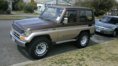

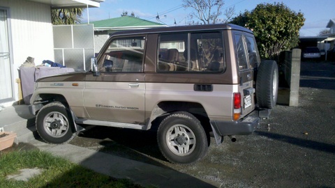

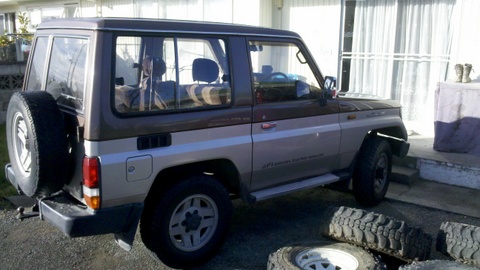

Hi all, So found myself getting fustrated with the hilux being off the road so long with modifications so found myself this truck.
Coil sprung solid axels full disc brakes its a bit short in the wheel base for my liking but would rather that than the long wheel base (personal preferance not a dig) is a bit standard so time for some aftermarket upgrades............

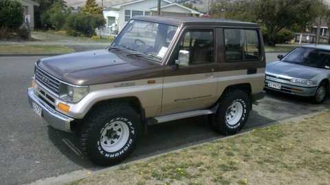

Seen ya (missus actually) playing round in that over at nsn/blenheim funday.
My mate had one and I was surprised how capable it was, even with open front and rear diffs. Is yours the 1kz model?

slide wrote:Seen ya (missus actually) playing round in that over at nsn/blenheim funday.
Yea i sold it to her that day she loved it after that i was allowed to modify it to make it betta. Na it was a 2.4 BUT today i sold the motor so..........................Watch this space

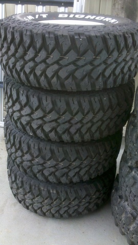

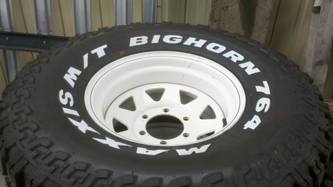

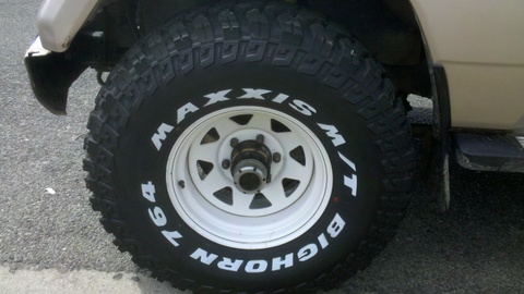

Look what followed me home
Tyres $1500
rims $250
grin on mew owners face $Priceless :D
To bad motor is coming out tomorrow :roll:
at least i wont wear them down :lol:

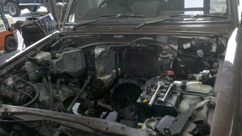

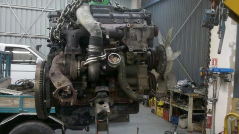

Sold the 2.4 turbo motor within a week of it being on TM so $1400 in the back pocket and 1 empty engine bay, interesting the differences between surf and prado motors, different powersteering locations & bigger starter.

With 1400 dollars burning in the back pocket i decided it was time to start building the new motor origionaly was going to put a lexus v8 in it but soon changed my mind as i dont want to have to tow it everywhere to get good fuel economy so 1kz with a manual pump is the way. I had a block sitting in the drive way so off to toyota and $1700 later i walked out with all new bits.
imsohi

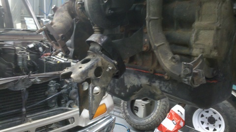

Motor assembled with new head, water pump, cambelt, full gasket set and the 2l-t injectior pump.
Old engine mounts plasma cut off and tidyed up then bolted onto motor ready for refit.

Looks like the twin to mine.
imsohi wrote:Old engine mounts plasma cut off and tidyed up then bolted onto motor ready for refit.
If it's not too late now would be a good time to check on engine mount- future PTO shaft clearance if you ever want to put in a winch. IIRC mine runs pretty close.

Post by imsohi »
hey thanks for that looks like i might have to modify in there at some stage have thought about pto winch. Thanks for the info.
