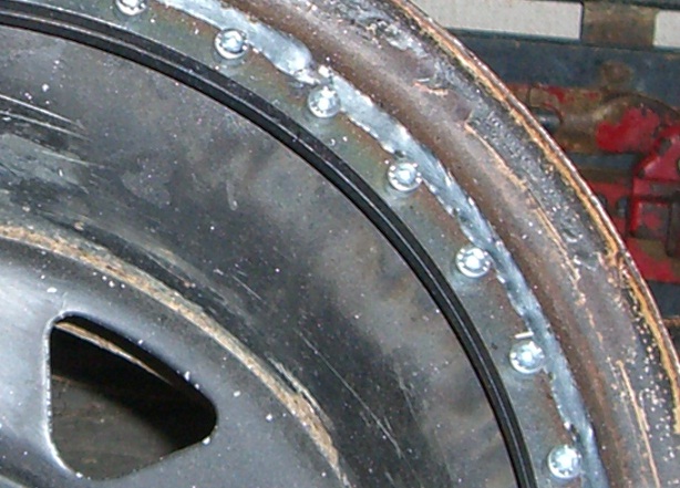

depends on what size rings they have used if you can drill the bolts out to 8mm, none of mine have enough meat left to drill them out larger and the 6mm capscrew heads are pretty much up against the welds on the ring, any stripped threads need a nylock on the bolt to secure it
wider rings and 8mm bolts look really

Just curious has this style been approved by the LVVTA tech committee
I ask becouse the hobby car techinical manual (the builders version of the LVVTA rule book) is very specific about the style of road legal beadlocks and that is the style in Sadam's pic
This is my prefered style to build... just didn't think they were road legal
