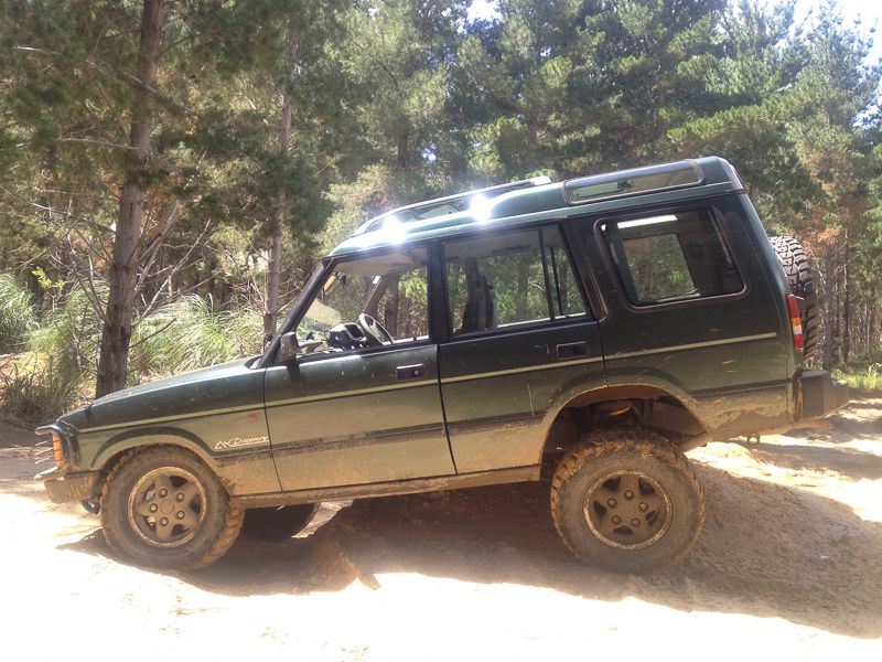

Here's a few phone photos of the truck over the past few weeks...

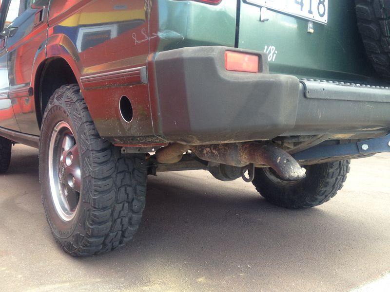

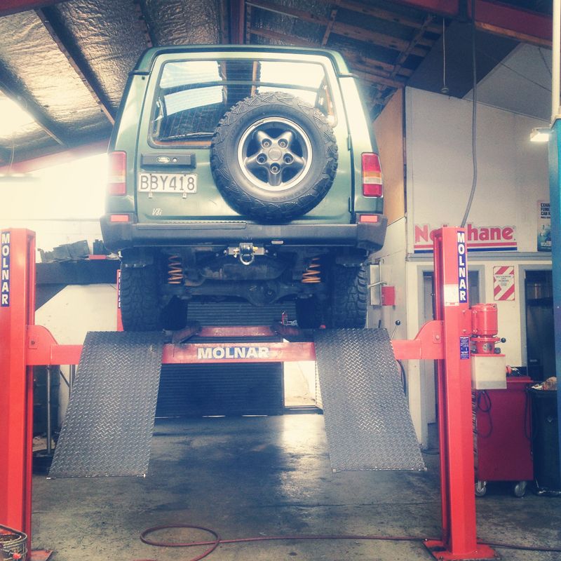

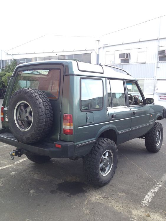

Mods....let's see.
I got the truck stock two months or so ago.
I had looked at a bunch of slightly newer discoveries....but this old girl was just in the best condition (rust-wise) of them all.
I threw on a set of 245/75r16 KL71s the day i got the truck. And raised it with 2" springs all around. Did a small camel cut to accomodate the larger tires.....but still shredded them pretty good on my first time out.
SO, I cut WAY more off the back guard and then all was good. Which got me thinking....BIGGER tires. haha. So I got 265/75r16 KL71s. By my calculations thats the biggest (32") i can go without really messing with guards and flares etc.
So now she's running an HD Old Man Emu lift - springs and shocks all around. She sits high and firm and the rubbing isn't too bad. I just need to extend the bumpstops now (and maybe brakelines) to stop the tires hitting the top of the guards.
PLayed around with the air intake - adding a K&N and a custom splash guard to keep the mud out. I don't think I'll go down the snorkel route. Well, not just yet.

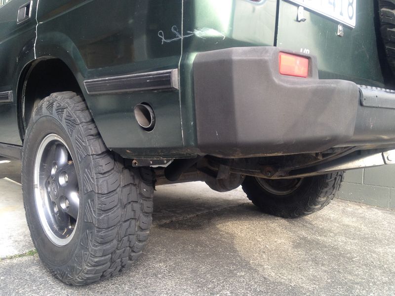

Routed the exhaust out the side panel and popped in a more free flowing muffler and now she sounds like a V8 too :-)
I've been doing lots of little things - mounting radio and antenna etc. But there's not too much else on my list now......until you guys inevitably start encouraging me. haha.
Definitely with the truck lifted as it is now I'm being tempted by 33"s.
She's gotta be my daily driver too....so I'm trying to keep things functional - just change the necessary.
with that said......i really do want a winch :-)

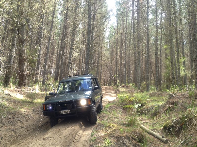

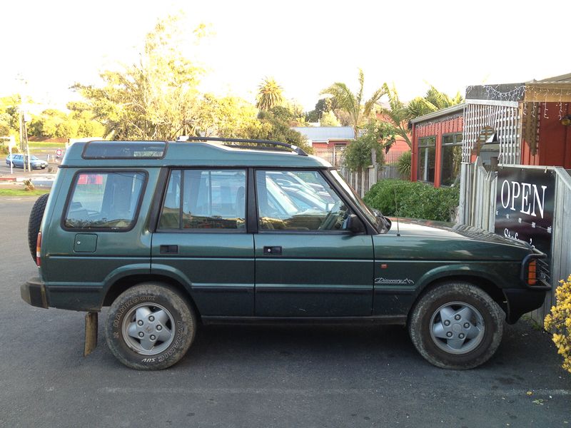

That's her on the weekend I bought her - off on a Waiheke mission.

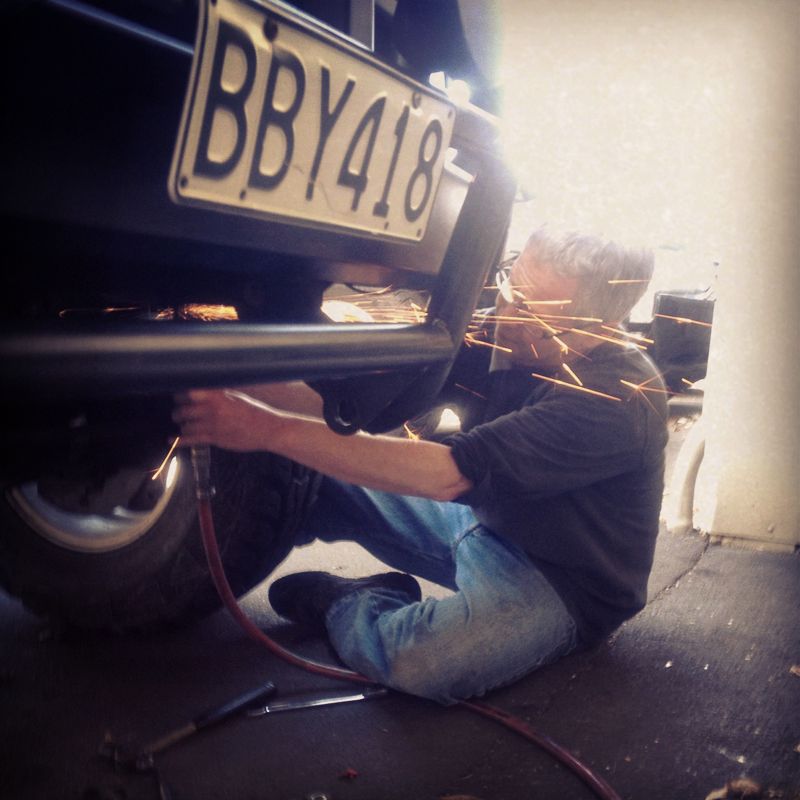

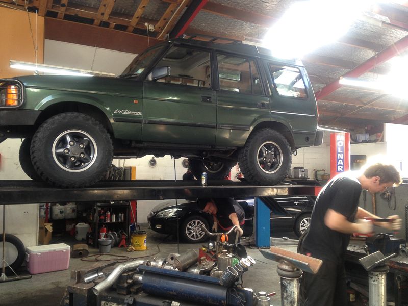

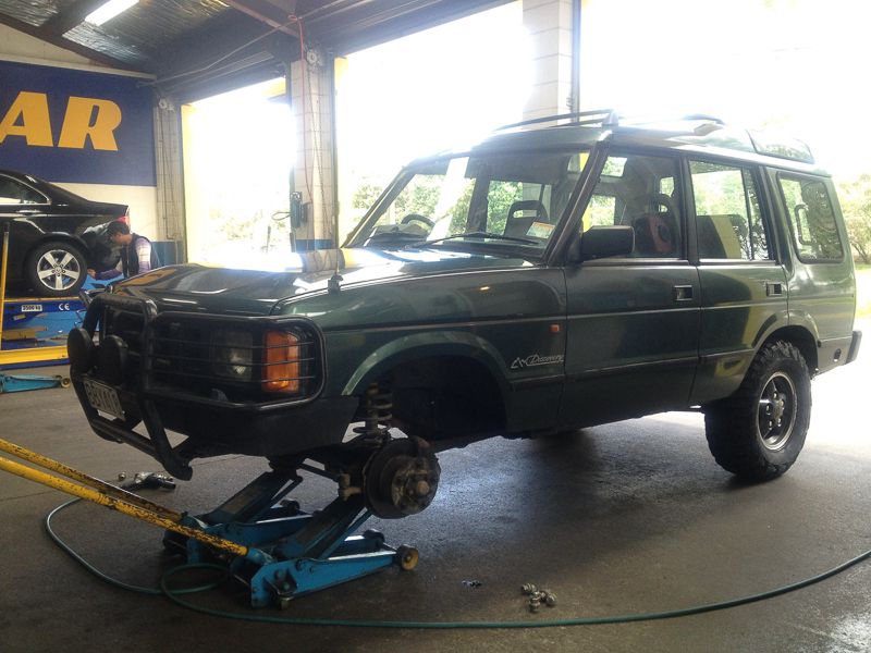

Here's a few under construction images as I've been giving her a bit of TLC...

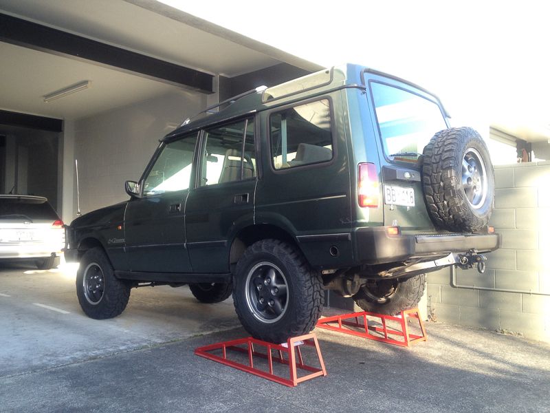

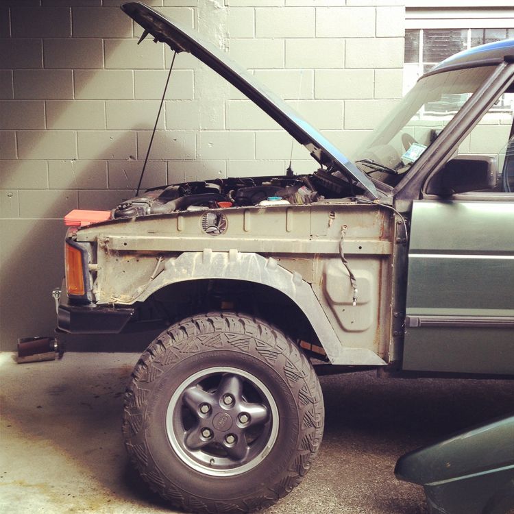

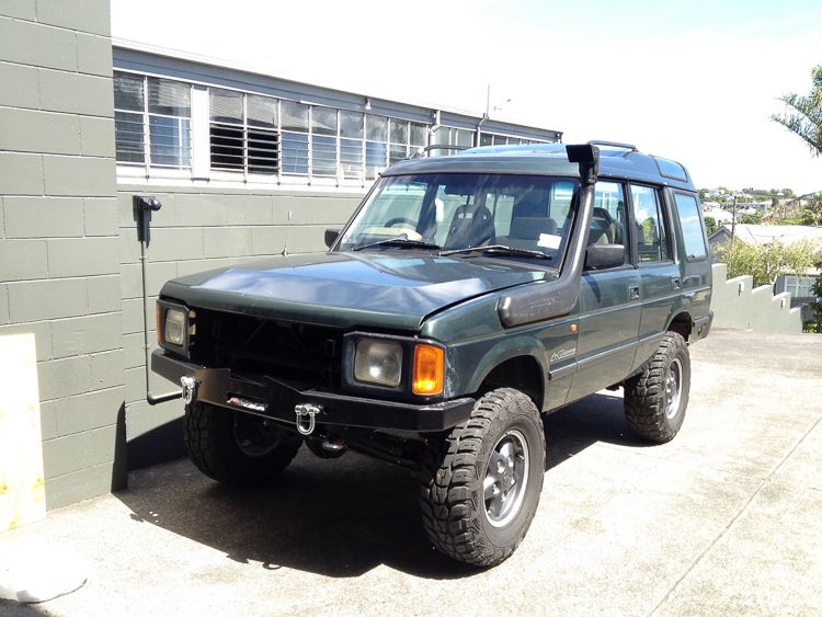

Figured it was about time I posted a little update on the disco.
Removed my 25mm Polyurethane spacers as they weren't sitting right. The front ones were squishing out. Instead, I installed some metal spacers below the springs. Totally not necessary....but I am pretty happy with the height she's sitting at.
Have some extended brake lines - but haven't installed yet - when I'm out offroad I'm paranoid of the back one especially at stock length. I check it after every decent flex!
Also added some 30mm alloy spacers to widen the stance a bit. I like it...but I've yet to test whether I'm going to have to trim my guards anymore.
Installed a winch bumper in anticipation of my Runva winch - should be here any day now! I was pretty close to just having a tray and bumper fabricated...but I liked the simplicity of a bumper where everything just bolts on....cost twice as much that way though!

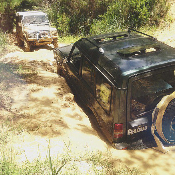

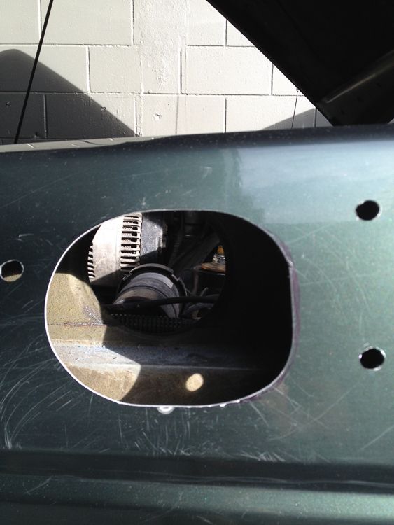

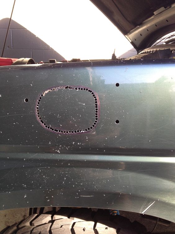

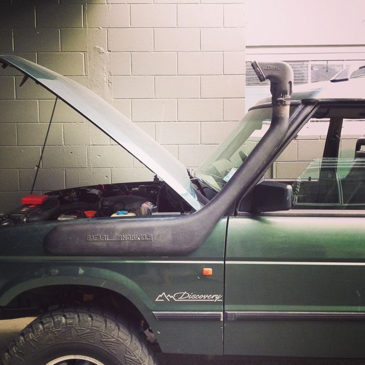

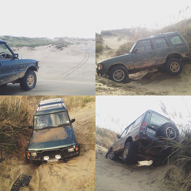

So here's a few images of adventures lately...chopping holes to make a snorkel fit...and finally as she sits on my driveway right now - wider, snorkel and new bumper!
Im currently working on modifying the airbox and plumbing all the snorkel pipes etc...so more pictures to come when that's done.....doing some serious DIY with plumbing pipes :-)

Post by phraza »
think i saw you park on Onewa road a few weeks back (near the church or something). Looks sweet! Should hit some tracks sometime
Loving the multiple drill holes for the snorkel 8)

phraza wrote:Loving the multiple drill holes for the snorkel 8)
I couldn't quite bring myself to splurge on the correct hole saw bit. I had to recharge my warehouse cordless drill halfway through all those holes there was so many! haha

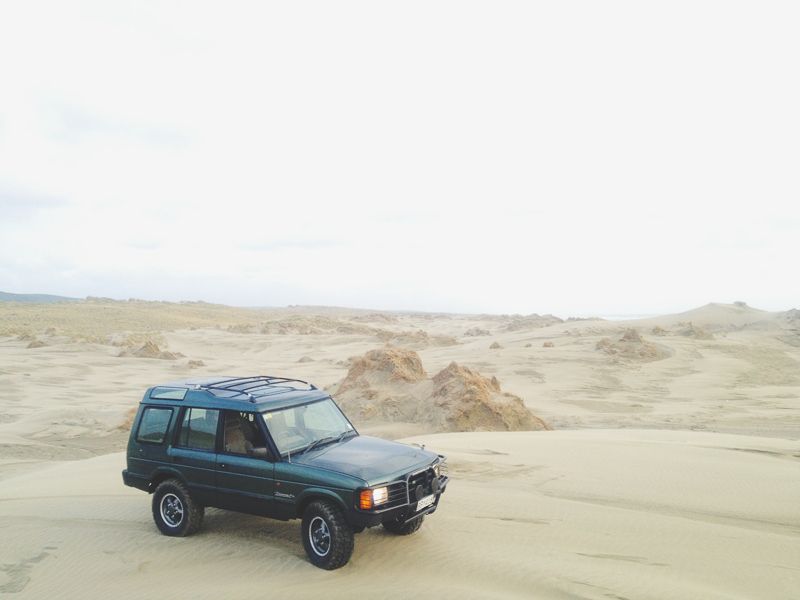

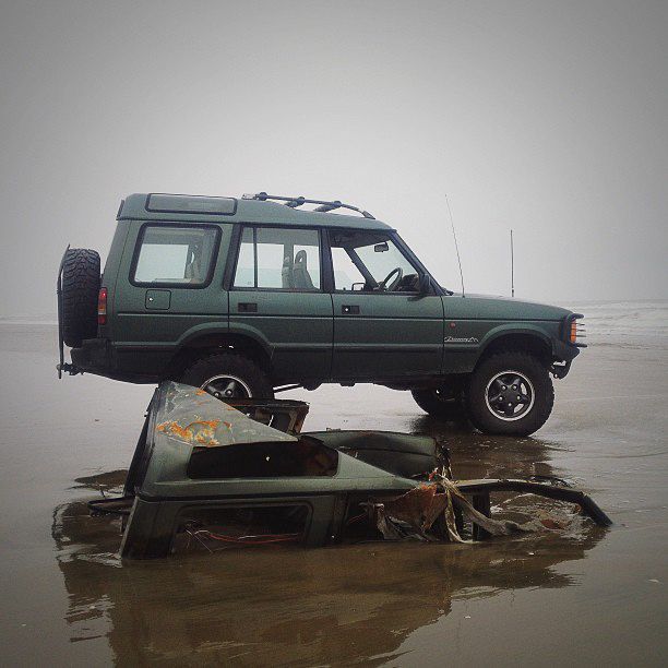

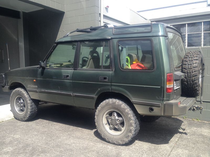

glamour shot post onewhero - pre clean...

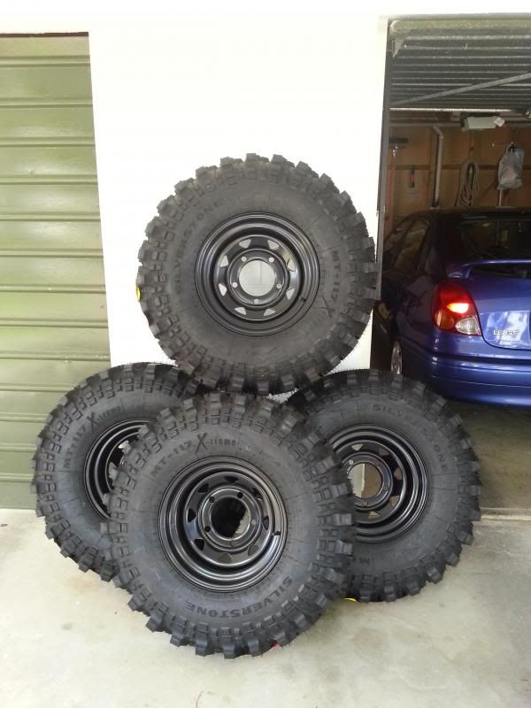

A little present for the disco.....some new winter shoes!

8) 8) 8) 8)

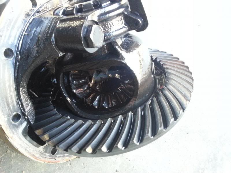

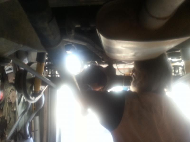

The continued adventures of Alex and his disco...

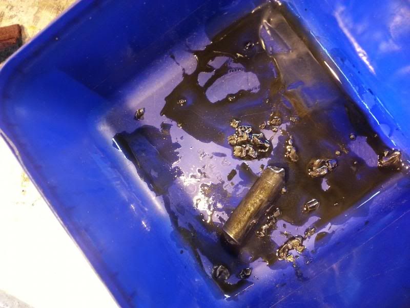

So, I came home from the LROCA Bethell's Beach run two weeks ago with an occasional clunking noise. It happened when I came off the gas....and was louder when turning.
I went through all the obvious simple things it couldve been...removed my wheel spacers....flushed the transmission (I'd been playing with it relocating the trans cooler)...checked the prop shafts.
Not finding the cause was killing me. I spent a week off the road repairing a stripped transmission sump plug before I could finally drive again to figure out what the heck it was.
First drive - i decided it was coming from the back. I was going to take out the half-shafts from the axle - but I decided to drain the axle gear oil first just to check......sure enough...out with the silver colored oil came big chunks of my diff.
I was stoked to have found the problem....

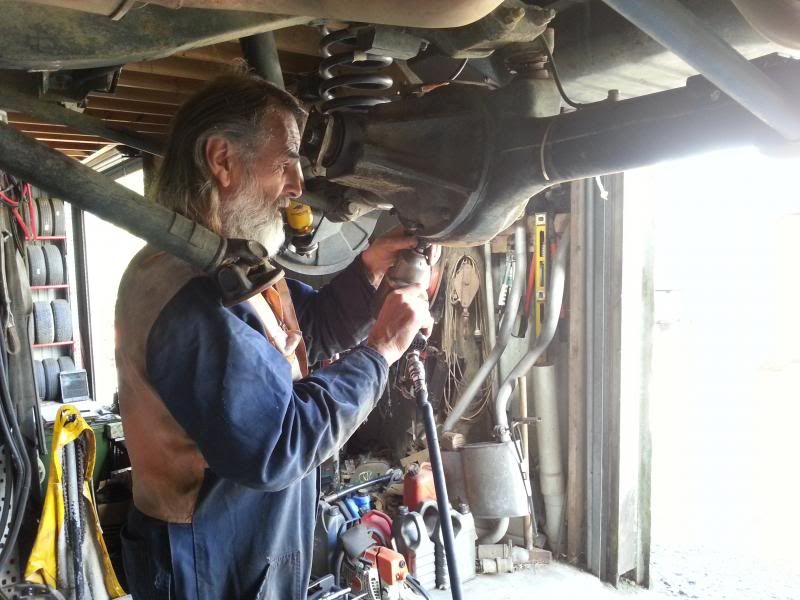

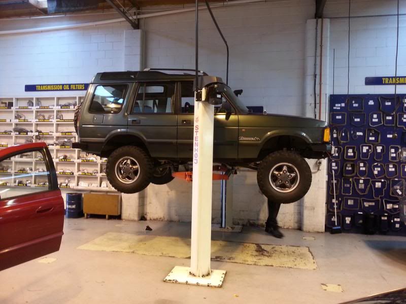

Off to see Tim at Bramble Downs who kindly helped me install a new diff head even though he had been feeling sick for the past few days.
The truck drives like a dream now! So smooth and way less clunky! My diff must have been on it's way out for months. I feel like it's kind of a 4x4 right of passage to break a diff. haha. now I'm finally one of the crew.....some pics of the broken bits...and tim helping me put the new one on...
Pedro
Posts: 902
Re: Introducing myself! - Alex + '94 Discovery
Post by Pedro »
if you drive it hard get used to it, look at the hilux diff head conversion..... front and rear

or get some salsbry diffs, seems most disco owners go down the weak diff path :|
