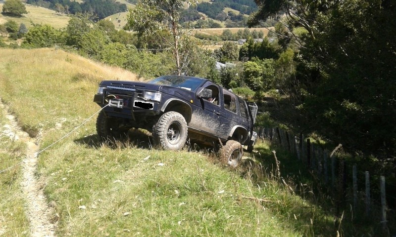

Oh I just love the Winch and Land Anchor.
Hauled the truck with pigs in tow off the bank. Off to slaughter tomorrow morning...yummy!

Hope you didn't treat those piggiest to an impromptu downhill adventure?.. Track looks pretty flat if you were following that sheep track's line...

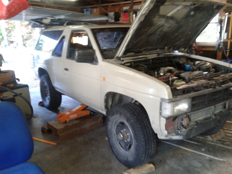

Finally got my front diff removed, and a r200a up where it used to sit. Unfortunately no photos as forgot to take camera :(, but its a squeeze. :twisted:
Had to space up LH engine mount approx 10mm to give sump clearance. :shock:
Time will tell if thats enough.
Big thanks to Sibainmud for chat, yep makes it much easier to cut out those bolts to remove subframe (ya might even say makes it possible :lol: )

You're most welcome Nath. I would almost considered to be an expert on D21 front diff removal and fitment :P

Don't want to go off topic, but I take it you used the R200 subframe/carrier? Did exactly the same on those bolts....what the *** were they thinking??!! :?:
