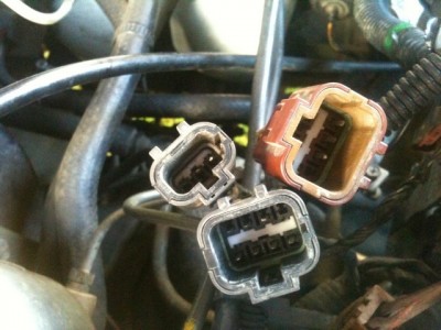

Yeah I got the plug on the box for reverse but have yet to find the two wires from the body to connect to it! Friggan cowboys with side cutters doin my head in!!!!

they will be on the right hand side of the engine bay next to the fuse box. from memory there are possibly up to three plugs (4pin and 6 pin) one brown two grey, if it was orignally an auto. If it was a factory manual it may only have one plug.

just did my reverse lights goes from the top of the box to a group of plugs next to the bat.
its the bottom grey plug 6 wires from it the 2 fatter 1s u want the only to that have cooper cores.If you havnt got the plugs go to a wreakers doesn't matter if it ant a safari as long as the plugs fit.

Success!
Green/white wire loops via the reverse switch on top of the manual gbox to the Green/brown wire in the larger grey plug that was disused since the auto was removed and manual installed
The large grey plug has the green/white wire and green/brown wire which loop via the reverse switch

thats the one :wink:
