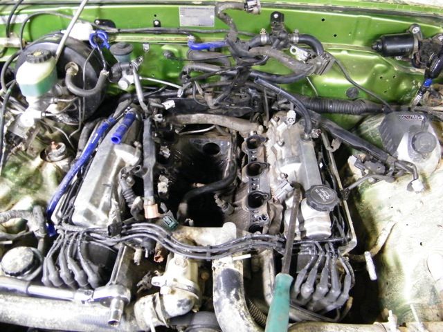

And if you think thats bad try a V8 hilux
See that little hole in the back of the valley? thats where it sits and the 2 bolts that hold it in come from the firewall side
