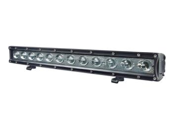

What’s your budget like? if you have a few $$ to spare I'd be going for an LED light bar. LED's have come a long way since they were just a little flashing red light on the computer. I did a bit of experimenting with the CREE XM-L T6 LED’s a while back because I couldn’t afford to buy a pre made light bar. Those things are incredible!! But if you are going to get a light bar you really need to buy good quality because heat becomes an issue when you are driving them hard and they need a good heat sink to last - would look pretty good under your cargo rack too.
- Attachments
- light bar.jpg (7.37 KiB) Viewed 4079 times
