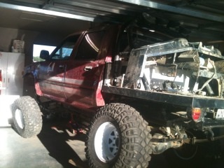

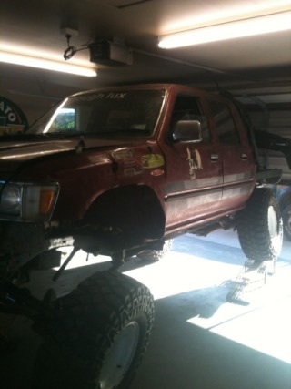

Just doing hilux standard rears up front conversion for a bit more flex and move the diff forward to fit the 35s creepy crawlers all we got to do now Is bump stops and shock mounts here's a few pics so far.. Goal is to coil the ass end and Exo cage it this year
We reacon we can get another few inches yet

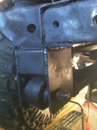

Custom hangers
Custom hangers

What is your spring mount actually welded to? Just the bottom of the body mount? Would have thought you would want to beef that up a bit?

Cheers for the suggestions Pete. We didnt do the front crossmember due to the front bar bolting to the bottom of the chassis. Might look at beefing it up or making the crossmember and modding the bar to suit.
