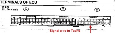

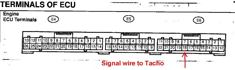

So you have KZJ71 wiring in the truck?
Which used to have a 1KZTE engine?
The Tacho sensor from the pump goes to the ecu... then gets sent onto the factory Tacho unit.
For the KZJ78 (similar to KZJ71) wiring ex 1KZTE is as per photo.
Hope that helps...
Think it was black with a red stripe and a silver dot.

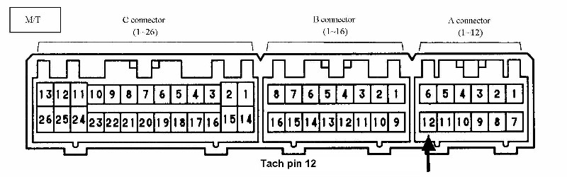

hi kbushnz,my pinout is a little different .my ecu is a manual one and the e6 plug only has 12 pins not the 22 that your one does .have found two black/red wires in that plug thou .one has 1 dot the other has 2 dots.dont suppose where you got that pinout they have one for my ecu .part no is 89661 60230 1KZ-TE M/T cheers sig
kbushnz
Posts: 2486
Location: Massey, Auckland
Re: kzj71 prado tacho help
Post by kbushnz »
OK stand by I have a pic of the manual one somewhere...
Try this one, Pin A12
