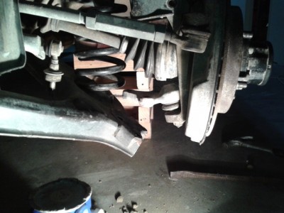

I have had a bit of trouble changing the front springs on my Vit.
I tried unbolting ball joint and lowering arm, but the ball joint was under the arm and wouldn't allow it to drop.
I tried unbolting hub from strut, couldn't drop arm enough because of driveshaft.
Would I be able to unbolt ball joint, and the strut, jack up arm till it was about level, then move the hub forward or backwards to get the ball joint from under the arm, then lower the arm, change the springs and do the whole thing in reverse.
Obviously the sway bar is disconnected the whole time.
Am I missing anything?
Cheers in advance
1994 LWB 1.6 16v Vitara

Well it worked!
3 bolts from ball joint to lower arm, sway bar, 2 bolts from strut to hub, then jack the arm up and down till there is no weight on the ball joints and side the bolts out and manipulate it out from under the arm, lift the hub up and slide a bolt back through holding it to strut to hold it in place, then lower jack releasing lower arm and spring.
