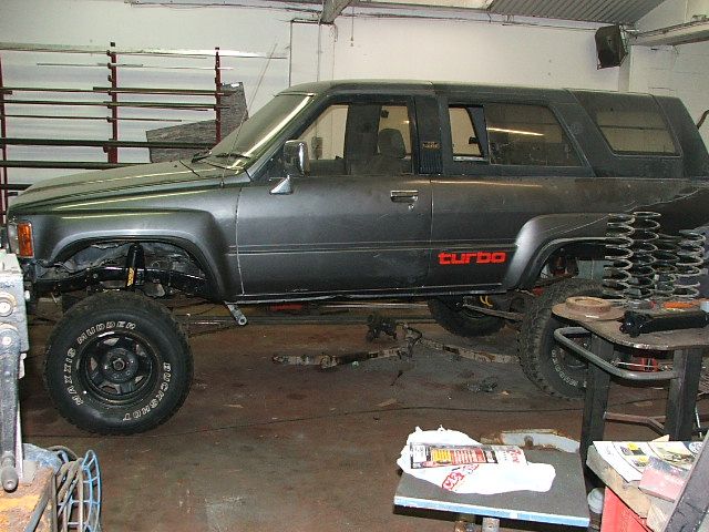

Well he's finally committed to one... a truck that is, a gen1 surf
A gen 1 IFS surf body onto a solid axle chassis with a little De Ranged style

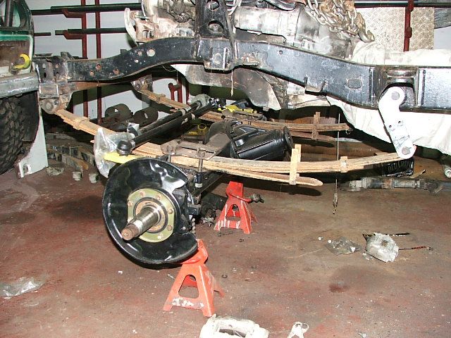

Set up the chassis on some tall jack stands so I'm all good to engineer, went through the shed and picked out some bits for him (place is on the market so I'm getting rid of alot of stuff, just in case) found some fun bits that I had given up listing on TM, not for lack of interest just sick of dealing with muppet questions
The Original project lemon front diff
Built this yrs ago and ended up parting out almost everything else

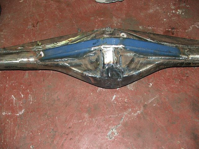

Shaved n Braced
Diff head rotated
Diff mounting bolts replaced with M10 button head cap screws
Swivil balls rotated to 3.5degrees of caster
U bolt eliminators
Swopped it to him for a standard housing and a diff
Finished it off with a few bits from my stock a set of high steer arms and a couple of 80 series tie rods I shortened
The springs are rears up front with a drop X member and +75mm extended shackles

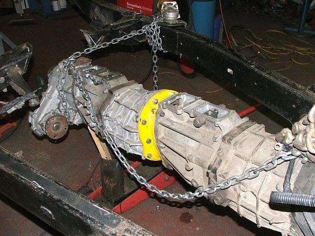

Next day rings me up "arghhh na... stick with the diesel, but can we do a deal on the boxes " :lol: so if anyone has a box for sale he owes me another one as part of the swop
Here they are (I deliberatly moved the 2lt out of the shot as thats just too sad to have in the pic)
We are going to need some drive shafts so if anybody has some toyota DS's they want to part with drop me a line

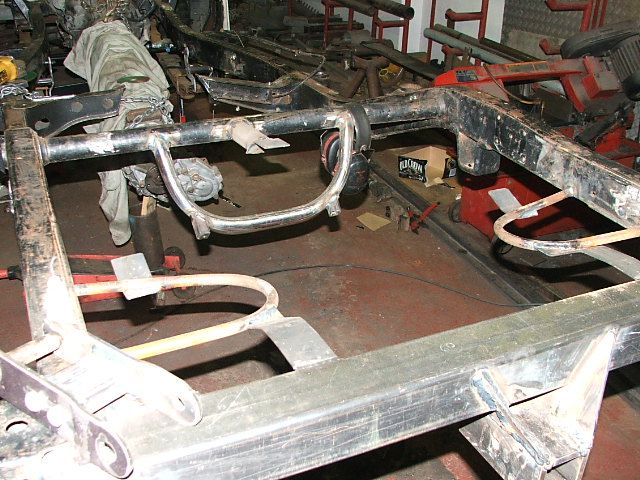

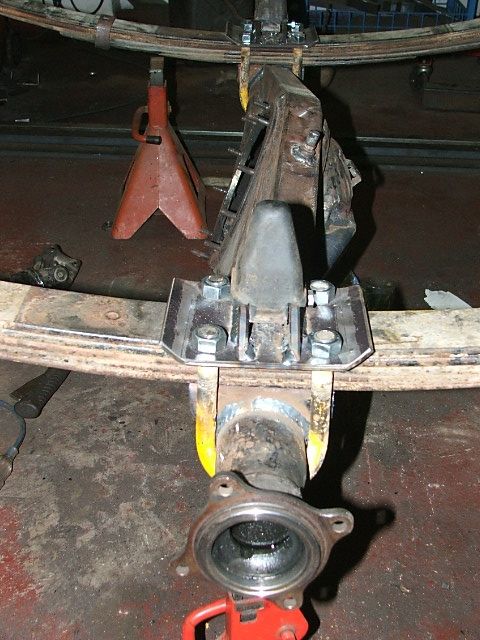

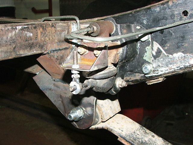

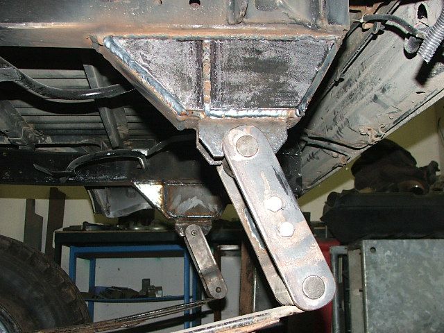

Made up a pair of custom Koon springs from a good late model set and some of a mates spare leaves, had to drill a couple of the leaves to move the pins (this centers the axle :wink:, the extra leaf is to limit axle wrap)
Did something a wee bit different with the new spring hangers
I feel its better to weld up into the stronger load bearing sides, also easier for me to weld on as I had less welding when I'm bent over :wink:

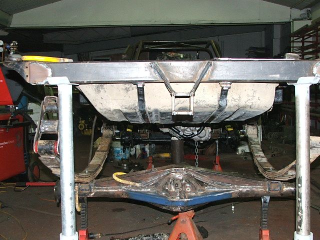

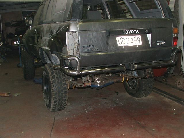

Nobber had been complaining about the surf fuel tanks hanging down so I solved that
Fitted a rover car fuel tank in the back of the chassis and cleaned off the old fuel tank mounts
I'll get a pic of mounted before he takes it away to drop the body on

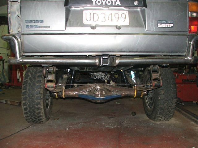

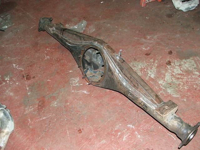

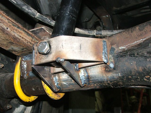

Shaved and braced the back axle, so it matched the front :lol:

nice work, but i don't mean to rain on your parade but given the fact that the two gearbox's now double the length of the front drive shaft maybe the rotation on the front diff is now a little too acute?
in saying that. you could use in the back and have four wheel steering?

At that length i guess it would be a 2 piece shaft?

De-Ranged wrote:all keen on the night he starts to pull it out along with the dual gearbox's bolted on the back
I've still got to sort the rear X member (hopefully this arvo)
i can see one transfer case and 2 gearboxes, as stated?

Yep its 2 gearbox's and one transfer case, and yes I am looking at doing a
2 piece front DS with a hanger bearing
It's a cheap way of getting extreme rock crawler gearing, this gives you the same gearing as dual transfercases with the extra low aftermarket gearsets and 5.29 diffs :wink:
Also gives you the option of gearing ratio's he's going to run 31''s for street running and buy a set of 35"s for play... leave the second box in 4th or 5th for street and drop a gear for the 35"s and he is still pulling the same rpm

the possibilities are quite endless with 2 gearboxes i suppose,
imagine low box, and both boxes in first, the crawl ratio would be amazing.

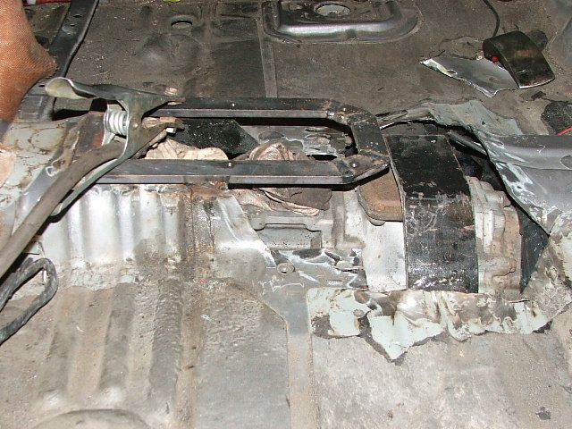

I'll have most of the engineering done on the chassis this weekend, the only sticking point is the front jack shaft I need a DS from a Double cab that has a hanger bearing... next option is raid the gearbox parts for an output shaft and flange hmmm
Pics to come tonight 8)

Cleary wrote:Nomis9 on here had a rack of driveshafts last time I looked in his shed.

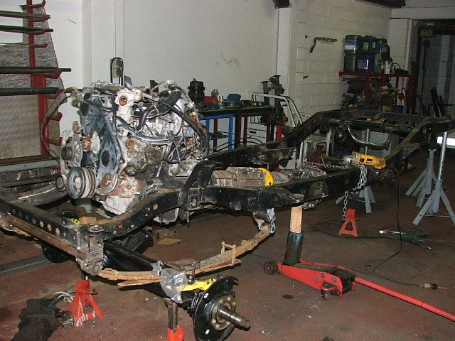

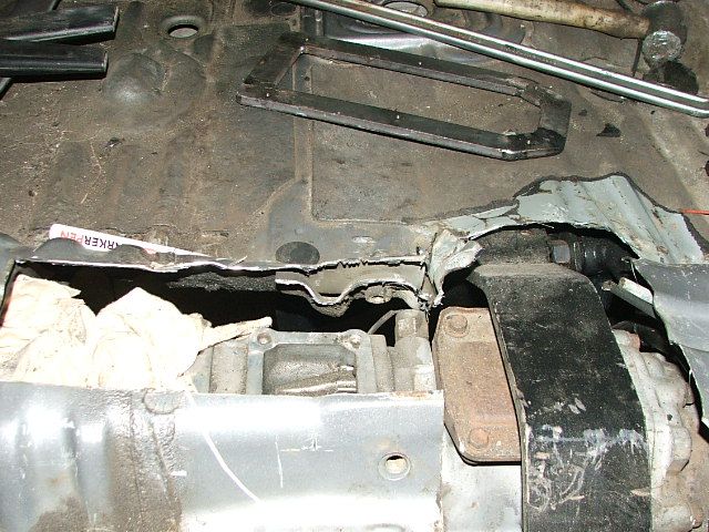

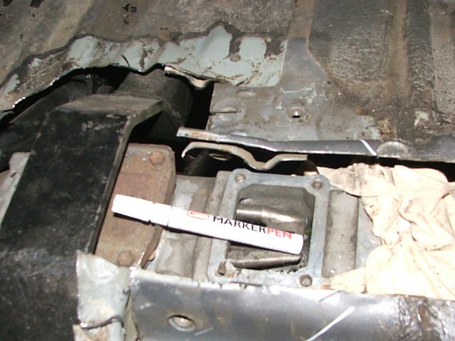

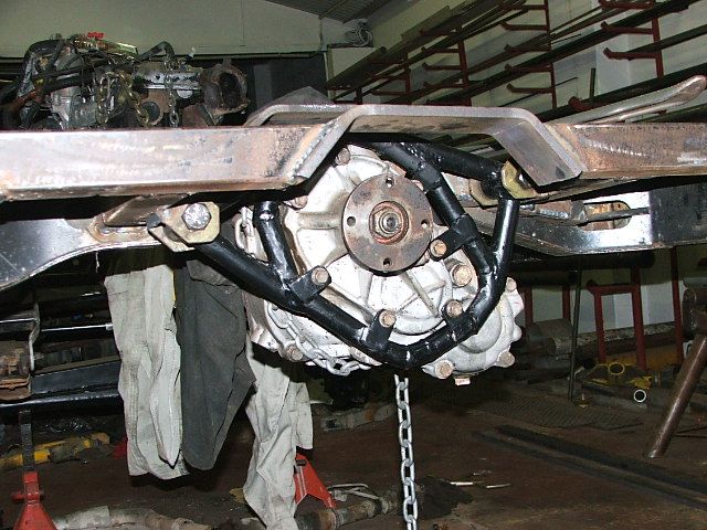

Think I've found an easy solution using a output shaft from an old transfercase that was stuffed, just got to talk to bearing shop about mis-alignment bearings or mounts
That was about the only success I had today :roll: was finishing off the transfercase mounts, was using the trolly jack to hold the gearbox up in position first FU was it moved sideways got halfway through the mounts before I noticed.... so all that had to be cut and ground out
So this didn't happen again I used the tail of the chain to pull it to one side if it moved I'd see slack in the chain
Get half way there again to before I noticed there was too much daylight between the top of the X-member and the top of the gearbox.... trolly
jack has crept down... I started to fix it and thought F it I'm going home :lol:
Tomorrow I'll weld a bit of scrap under the gearbox with lugs so it can't move :lol: and start cutting out todays effort
So no pics hopefully tomorrow :lol:

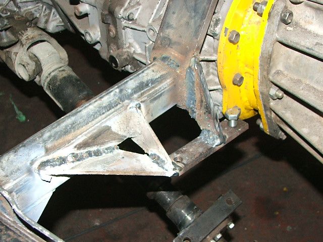

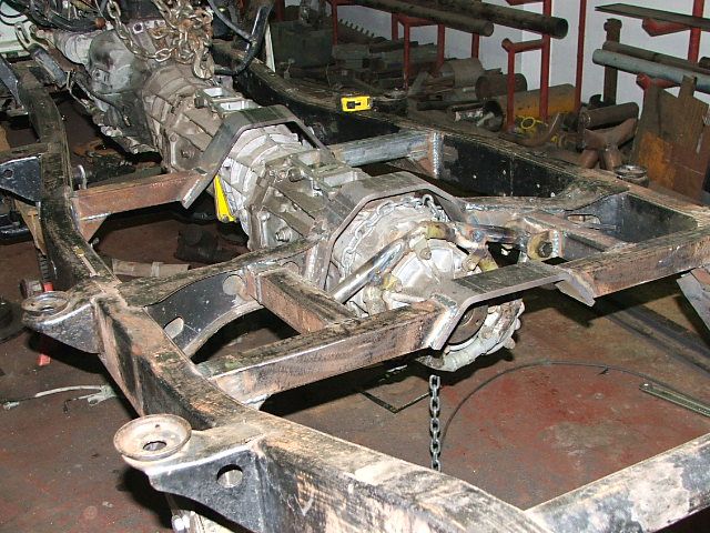

A wee update.... I got it :lol: third times the charm
X members all setup
Next up rotate the rear axle to line up with the output from the transfer case and sort out shock mounts

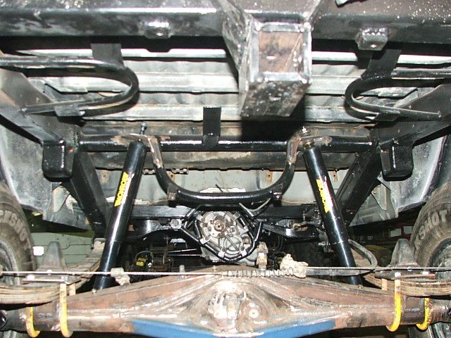

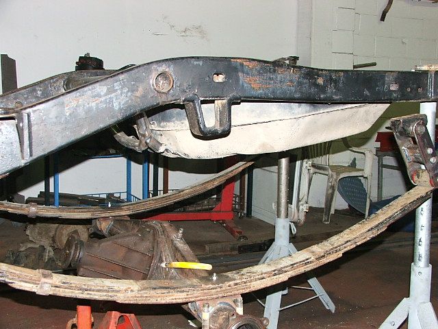

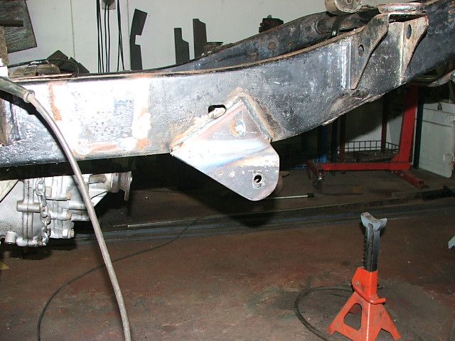

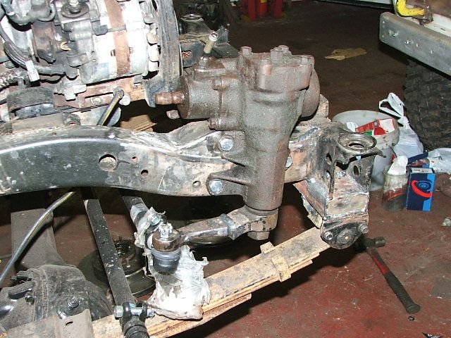

Just a few things to sort before it roll's out to get the body
Got the steering box mounted
Just got the shock mounts and bump stops to sort for the front, but I'll do that once he has got me some shocks and body is on

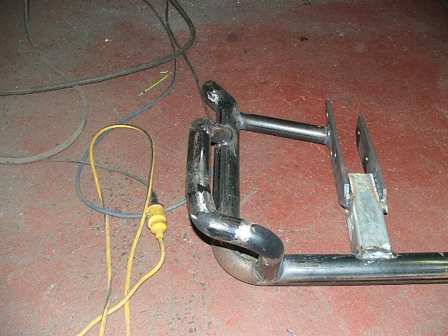

Here's a couple of shots of how the tank sits in the back
Rear axle has had new perches done to rotate the diff head up to minimize DS angle I've done the rear DS as well, just shortened up the original.... and took a guess at how much the springs will compress with the body on and spot welded some blocks between the rear shackle mount and the chassis

Just some more pics, since I happened to be down (getting down and up is still a bit of challange :roll: ) I got a shot showing the gearbox mount, its something that had been floating round the shed for yrs... got a suspision I made it about 8yrs ago for mate and when he parted out the truck it came back ....
Heres the back axle with the new perches and the diff head rotated
Cheers Reece

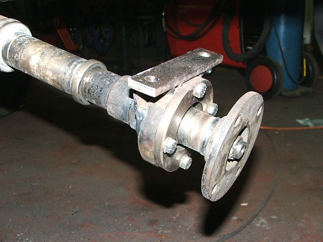

Since there was a bit of interest in the front drive shaft hears my answer...
I've set it up with a jack shaft, to hang off the front X member I built up over the gearbox, since he is on a budget I tried to use what he had so I used the old IFS front drive shaft
Cut the UJ off the end and machined a front output shaft from a transfercase I had lying around.... love machining heat treated shafts :roll:
Heres the end result
I've used the double carden joint and the slip joint to deal with the slight cahnge in dirrection.... there will be a slight wooble from the UJ's as they rotate, a standard missalignment bearing would have delt with it... but with a short life span. Talking with SKF they offered a rubber collar for $12 unfortunatly I'd need to make my own mount
I did look at using a hilux hanger bearing and a 2 piece shaft but with the extreme angle and the increased torque from the double box I didn't think it was worth going down that path
The only part I'm not happy with is the mount to the X member
Don't get me wrong its not going to move, its just that it don't look cool :lol:

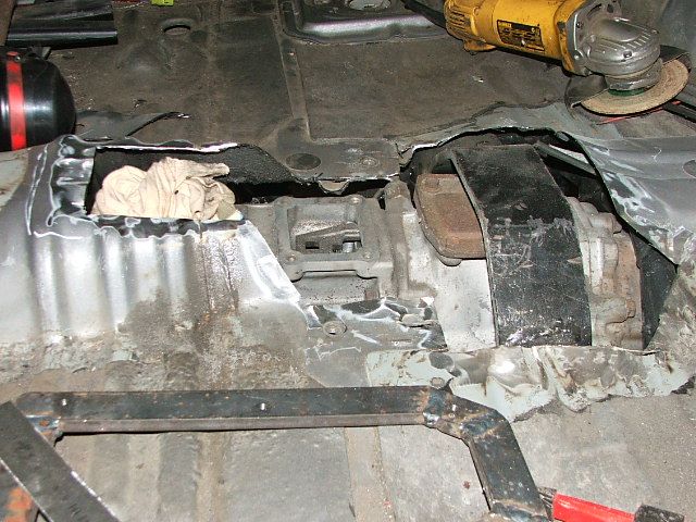

Reece, I saw you making t=at gt/box mount and my truck was about 1 yr old. So if you really want a date of build, that makes it mid 2006. LOL.

:lol: I am working on the russian.... got the front axle back in there and eyeing up a bit of a change might be cutting some of the frame work out and updating things :lol:
The back is very frustrating spend 12hrs down the shed but only acheive a few hrs worth of work :roll: found tramadol coden and bourbon solves the pain problem.... don't seem to achieve much tho :lol:
Yes you are right bob made those adapters more than a few yrs ago made half a dozen theres one other in the shed that my shed mate bought with some parts the other 4 I have no idea

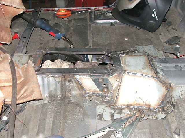

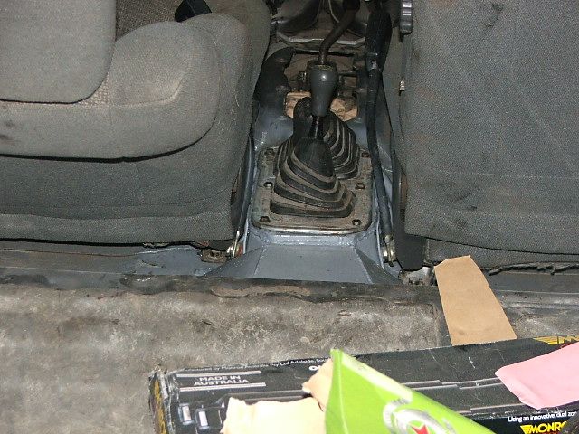

Trucks back at the shed going to sort the trans tunnel first
My measurements weren't too bad the only part of the trans that didn't fit under the floor is the "horse shoe hoop" factory X member.... the rest was close :lol: very close, would have been a bit easier if parts had been trim'd when the body was put on but I can deal with the issues just means it'll take longer :roll:
Made up a 10 x 30 frame for the gearbox boot doing this as I've had to cut out a section of the seat belt reinforcing rib that runs up under the trans tunnel
Heres the issue
The section that is real close to the box is the reinforcing plate for the seatbelt mounts... if this had been trimmed off when the body was up its just a case of adding some 3mm plates as replacement....
The easiest way now is to
Take it out from the top and rebuild a new floor section and seat belt mounts
should have this sorted tonight and I'll be able to set the rear suspension
De-Ranged
Posts: 1883
Location: Hawkes Bay
Re: De Ranged Nobber truck
Post by De-Ranged »
The answer to the problem
Welded the boot frame to the front of the tunnel
And then filled out the rest, the seat belt anchor has the doubler plates plug welded on the inside with the original captive nut
I know its a bit of a cheat to do it in multiple pieces but its easier and faster :wink:

Got the suspension leveled today....
set the height by the height of the rear shackle mounts... I've then welded some 10mm to the outside and 5mm on the inside so I can tap into it for mounts for the rear bars and the recovery hooks
Fingers X'd I'll get the rear bar mounted and the shocks mounted tomorrow
De-Ranged
Posts: 1883
Post by De-Ranged »
Got the shocks mounted... bit tight with the fuel tank, but the tank mount bar is a good way to strengthen the top mount
Also got the rear bar done
Really injoyed doing these

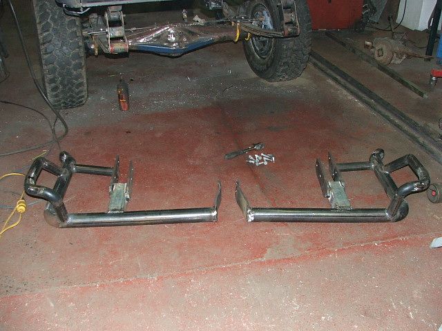

:lol: I don't think Hux would call me a mate, I wouldn't have a clue what he is up too he's still around I hear of him still doing certs but I don't know where he's working
Nobber rocked up last night put the tank in and the bars on
Not too bad a ass end, the tank tucks up nice
Just got the filler tube to weld up, noober cut the sections I've got to weld it and sort a mount
