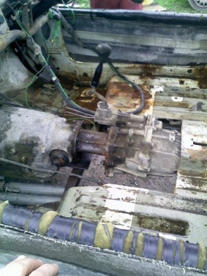

my mate did the v6+holden auto onto bighorn transfer case into a 1000cc suki farmworker. I Just finished making the adapter plate for mine so could give you the templates to make your own bracket? then you just bolt it all up...
check out "mudatruka" on youtube and thats the suzuki.

only got the cardboard templates scanned into a PDF which wont let me upload, i can email them to you?
this pic is the suzuki farmworker showing the adapter plate.

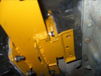

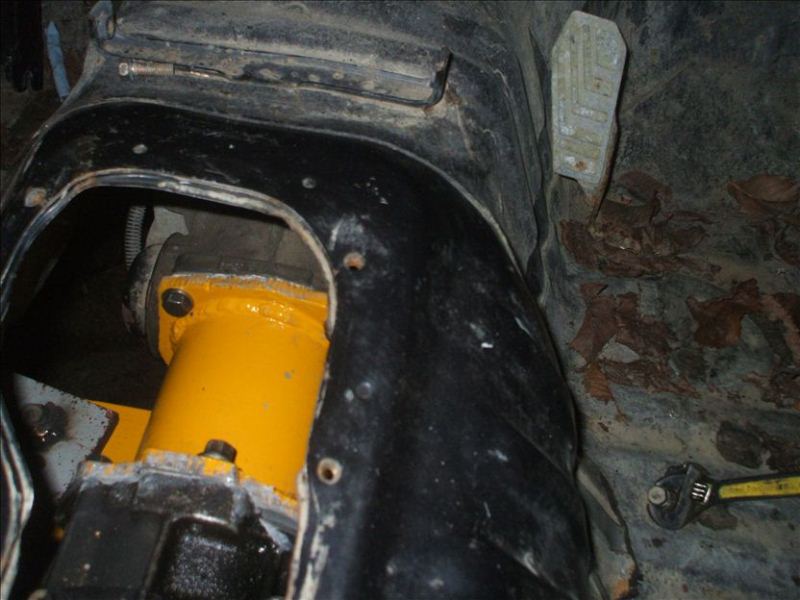

mines only a hack build that im doing very slowly and very cheaply, hope it all holds....
