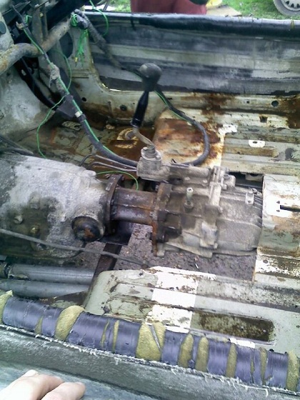

this pic is the suzuki farmworker showing the adapter plate.
