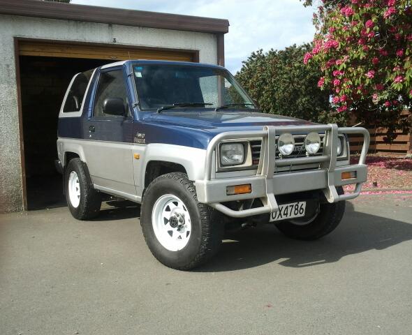

Hey guys im new here but im wanting to do a engine swap on my 1990 diahatsu feroza EL currently has a 1.6 carby motor , was wanting to drop a 4age from a corolla/trueno in to it , just wanting to know am i going to need to do alot of modifying on the engine mounts or are they reasonably the same? , thanks

never worked on a daihatsu but I would expect the engine mounts would be the least of your problems . Expect they will need changing but what are you going to do for gearbox ?
Would another engine from a similar model not be better .

just done a holden v6 conversion on my daihatsu rugger. used holden v6 + auto box and isuzu bighorn transfer case.
New engine and gearbox and transfer case mounts, radiator mounts, front and rear drive shafts.... pretty much had to do everything.
Also will the diff, axels, cv's... handle more power?

my gear box in it current condition may not handle the extra power from the new engine, the current motor has done 350,000 kms , so by the sounds of it ill need new gearbox,tranfer box and axles as well , the cvs are in quite good condition , well the boots are anyway , not split or damaged , its been a good truck so i want to rebuild it with a new motor, ive seen some one one youtube put a 400 and something cubic inch v8 in a rocky of roughly the same age
