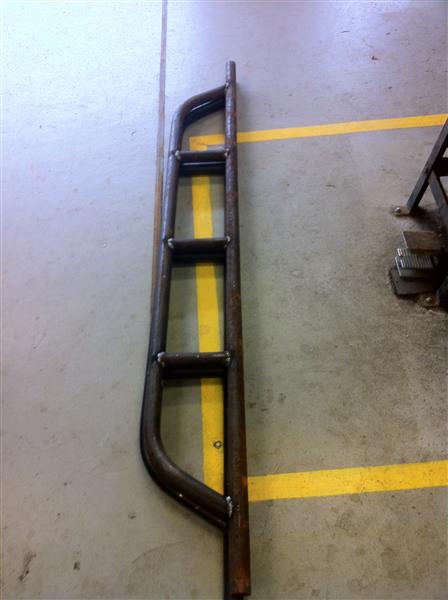

Well the sliders are sort of finished, I just have to make the brackets to hold them on there now. Now you can see the reason for the jig.
They are identical

lax2wlg wrote:Its the difference between a professional craftsman and a redneck with a pipe bender...I want sliders like that, just chopped down to suit the 'finder wheelbase.
Hardly, If you went into a fab shop and said I want a pair of sliders I can 100% guarantee they wouldn't make a jig off the first one to make the second one, any good fabricator could make a pair and get it within a mm.
The more likely scenario would be the boss riding the workers ass cos the customer complained about the bill because of the extra time.
The jig did serve a purpose in this case, Jigs have there place.

Mmm not sure about that. I have seen some crap jobs by fabricators that would make a person cry. I like to use jigs where I can so that I know things are spot on. I guess it's just me and maybe I am a bad fabricator
I'm going to be bolting them on. I will make the brackets next week, sandblast them then paint them

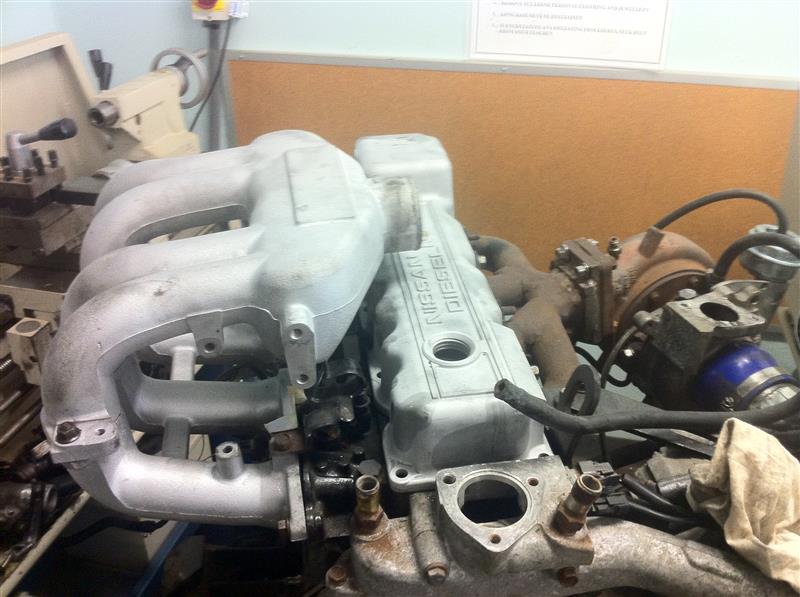

Ok picked up the engine today
Going to need some work and a conrod but all good. I can fix it
Looks its a td27 with di pistons.
Its also a td head with out precoms

Nice sliders. Just wondering, how did you bend the tube? Look mandrel not crush bent....
Is the 'outside' tube with bends one piece, or joined?

Hi daniel, its a bender we have at work. Its not mandrel but its close it sort of rolls it. I will try and post a picture of it, but it is one piece of pipe. Its 2000mm of 32 nb pipe

Went into work today and finished welding up the rock sliders. Just have to make the mounting brackets now.
I sand blastered the rocker cover in preperation for its paintjob, kinda cool looking cover it looks heaps better than the stock one.
I cant wait to get this engine going
