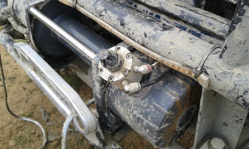

Saw this in action on Saturday, works a treat.
One of the guys down our way makes them.
Pneumatic actuator
