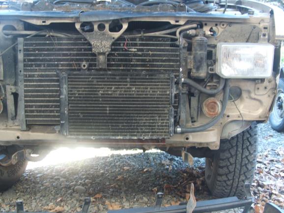

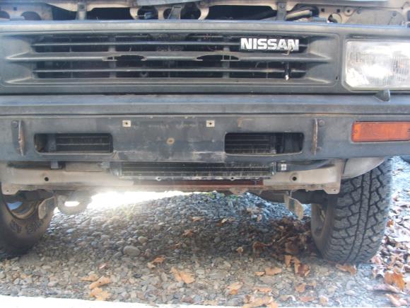

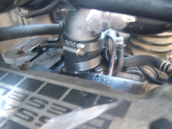

I thought I would post some pics here as well as in the newbie section of how I fitted my intercooler and radiator. The radiator is a very tight fit as I still have functioning AC and don't want to remove it.

Re: D21 Water to air intercooler install
the ic looks nice and simple
wheres the water pump? looks like its above the radiator. best place for pump is at the bottom.
I chucked my radiator right up the top, cut the middle support peice and welded flat bar over the top to hold radiator in place, and keep it nice and high, also to get as much airflow as possible.

I dont have a pump on it yet, I am planning on putting it behind the left headlight. Does it really matter where it is? If it gets the water circulating I will be happy.
I put the rad low as it wouldn't fit behind the grill without cutting half the back out and my decorative bull bars protect it nicely.

Front mount intercoolers vs Water to air intercoolers can be a very interesting topic,
For example, with a front mount intercooler, depending on how it is setup you gain alot of area that has to be compressed by the turbo (cant find the right word for it)
However, with a water to air setup, you have the same amount of area (roughly) as a top mount, aswell as cooling the water and therefore the air from a source well away from heatsoak.
big disadvantage, not so much with 4x4's, but with performance cars is that you are then carrying around the extra water (weight)
The other good thing about water to air intercoolers, is that you can run an ice box or equivalent in the boot of the car without adding more piping.
