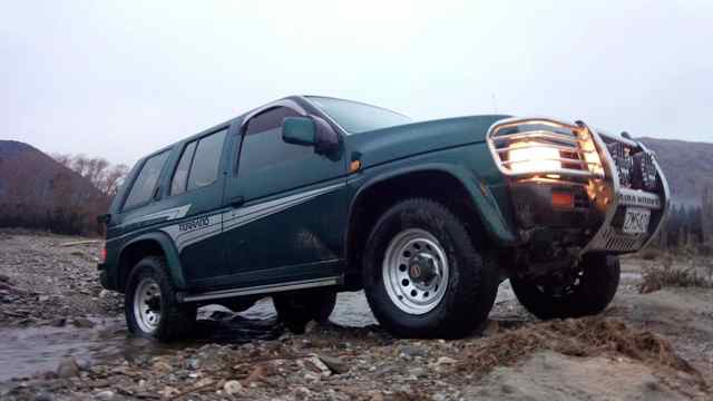

Hi there, Nice truck!, I am 16 years old and I live in wanaka, I have now owned my 1995 2.7 TD Terrano since the start of this year, I work at an engineering shop here after schools and saturdays so I am very keen to mod my Terrano a little. I want to fit a snorkel but cannot find any relevant information on how to fit it, I have heard its very difficult and most of the front end has to come off? Any help would be much appreciated. :-) :D Here a photos of her. :)

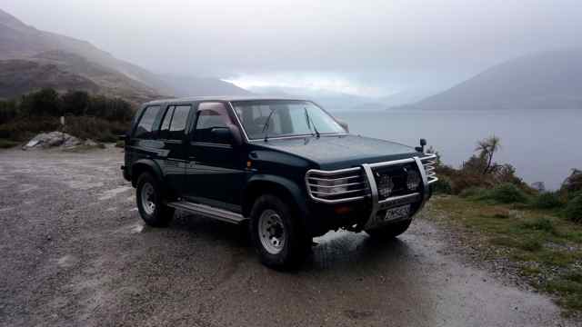

Post by maxnz »
:D
just a photo after the tortion bars were re-adjusted :)
